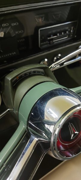

Hi,
I am converting my 1966 Belvedere with a 727 Coloumn Shift to a 4 Speed manual.
I want to get rid of the shift indicator on the column. The collars I can find are only 68 and up, I guess they are different and you need a 66 one ?
Next question is: The lever at the end of the column for the shift linkage is there a way to eliminate that, or is cutting off the only way ?
Claus

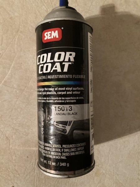

When it comes time to paint it the best (IMHO) color to use is “Landau Black” made by SEM. From what I have heard, that is the color that was used by mopar. I have also heard SEM is the only supplier. Every time I have used it I have been completely satisfied with the way it matches oem parts
