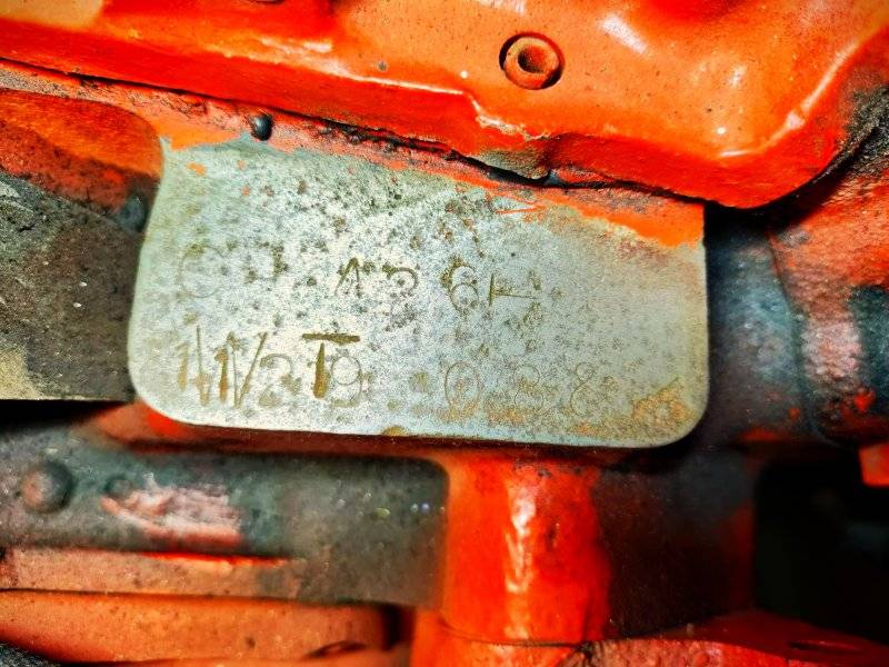

Can anyone help ID the stamping on this hemi I have in a 66 coronet.

Ok, I guess
C mean 67
426 means Hemi
WT means water test
11 29 means November 29th
088 means 88th engine built today (wow, that sounds like alot)

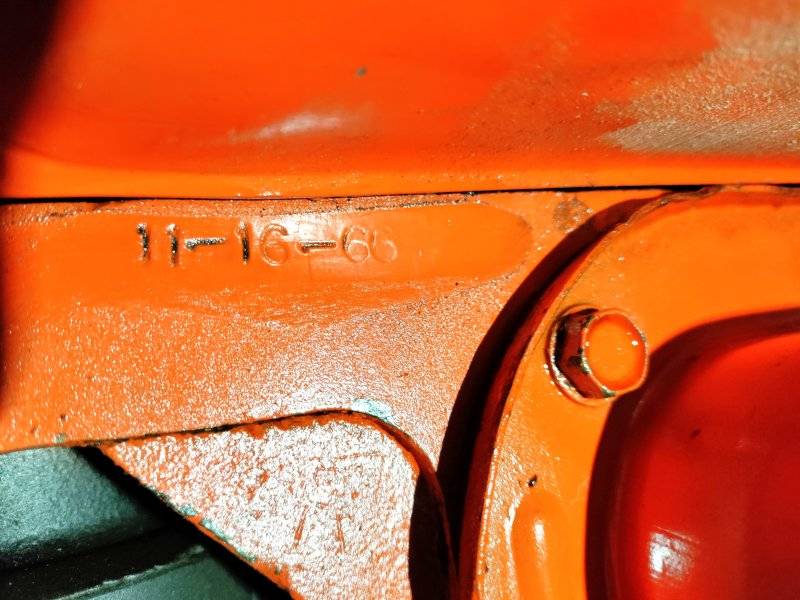

Thank you. the 088 part was throwing me off because like you said that seems like a lot, there is also a date stamped by the starter ear that reads 11-16-66. any idea what the "T V" stamped on the engine pad behind the 426 means ? its pretty faint and stamped the other direction of the ch 426
11-16-66 on the starter would be for a 67 car. Look at that second 8, it looks funny, maybe it isn't a second 8. 8th of the day would sound more reasonable. I don't know about that TV. What is the build info on the bottom of the motor?

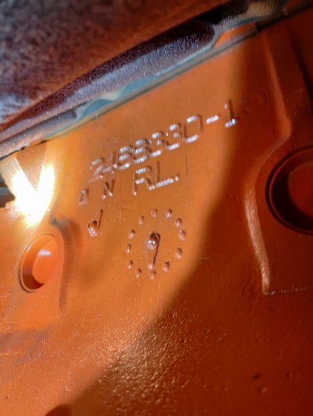

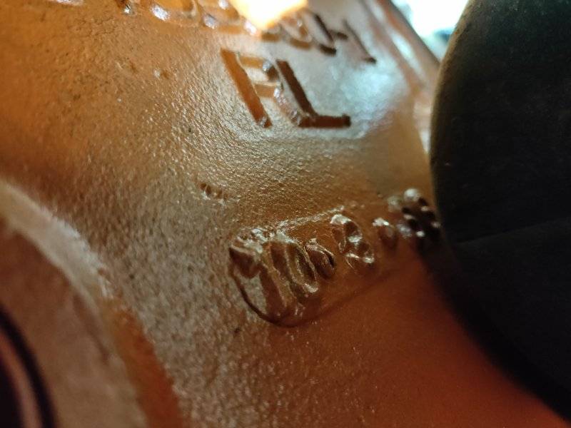

the casting date is 10-3-66 , I agree the second 8 looks funny ,the TV and the funny looking 8 is what has me curious

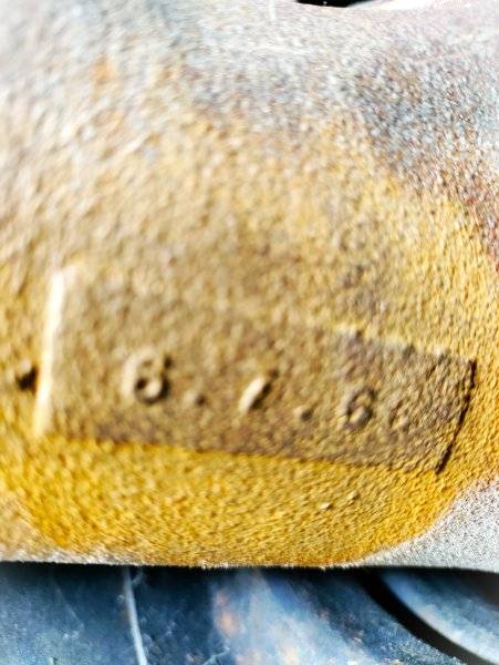

That is all the stampings I can find anywhere on the block . The vehicle is a 66 coronet 426 with 4 speed manual, seller claimed it is a all numbers matching car, got the fender tag and ibm card and had it decoded so I'm trying to verify the drivetrain. it appears the engine is from a 67 but not positive on all the stampings on the engine id pad, I don't believe the transmission is correct either as the ship date on the ibm car is 01/06/66, there looks like a date casting on the transmission tail shaft that I believe reads 6.7.66
As you can tell the block was cast long after the 66 model year had ended. Even if it wasn't, 66's didn't have VIN stamps no 66 or 67 can verify that it's the original engine. Everything says the engine came in a 67.
