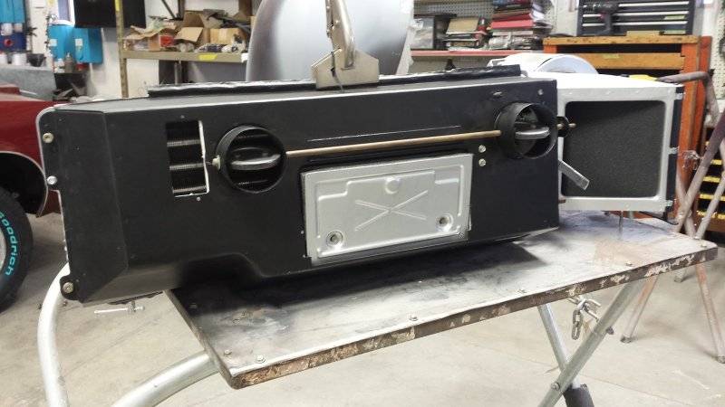

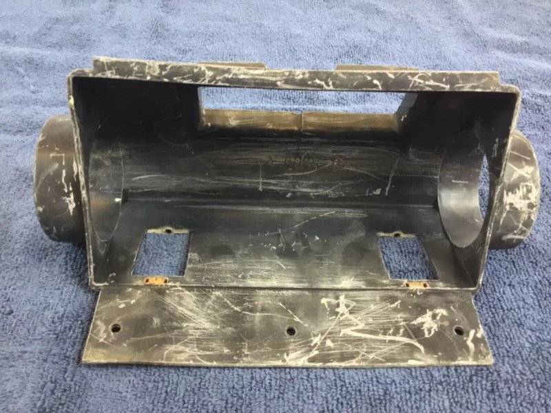

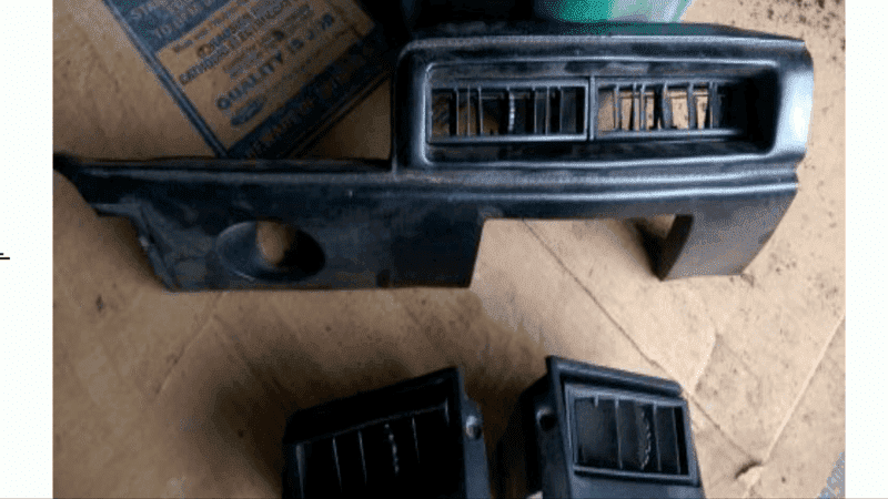

Hello, I am new to this forum. I am done with a 1968 Dodge Charger RT but as usual there are minor things left. I had the AC vents (center, left and right). However, I am missing a part to connect the A/C / heaterbox to these vents. It should be a duct of some kind. I enclosed three pictures (stolen from internet as reference). I trying to figure out which part I am missing to connect the A/C. Today it just blow out under the dash. I also found some form seals on detroitmuscletechnologies that seems to be added. Any help of the part in need is appreciated so I can finish this job (I beleive it could be the 3rd picture). I live in Sweden so I have a bit of a challenge to source part locally. Thanks in advance.

If you have the tube's going to both sides, the 3rd picture is what you need to connect everything.
Yes, I have a tube going to the left and and right vent (on the front of the dash close to the door). In addition, I have a center vent as well
