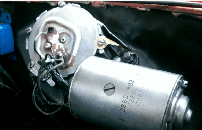

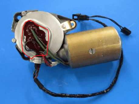

Can anyone tell me what the material is that seals the wiring is & where I can get it.

Glyptol. Should be available at just about any electrical supply place. Same **** guys paint lifter valleys with !!
