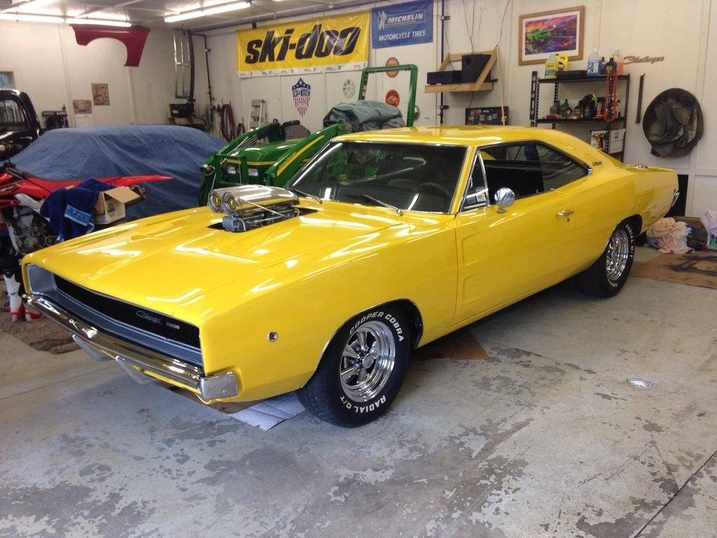

That car looks great! I'd keep the tunnel ram.

Thanks man! Spent alot of time with him working on it over the years. :( I'll be keeping it for now while I start my search for a nice clean original hood. The biggest thing is I love the look of the stock lines of the 68 Charger so the tunnel ram kinda gets in the way of that. Love the look of the Cragars though.

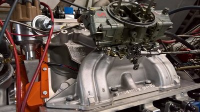

i know this isn't what your looking for but, this is the nicest driving/over all performance intake system i've ever used. this is on a stock stroke 440, mild mech cam, rpm heads, tti exhaust, auto trans (no loose converter), 3.23 gear. if it was a stroker i have no idea what i'd do with the extra torque. power is very smooth; easy to tune. big cubes want air.
