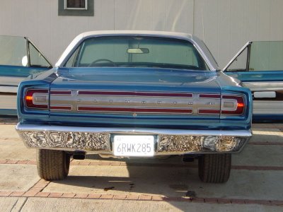

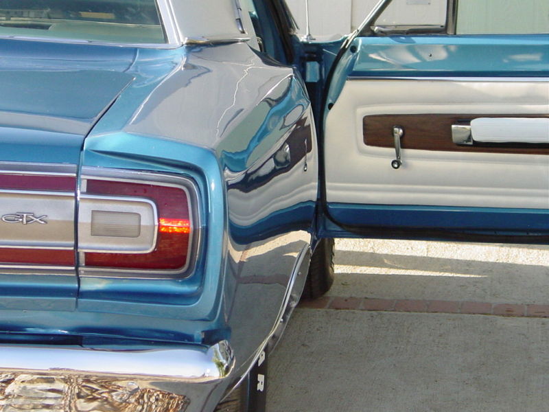

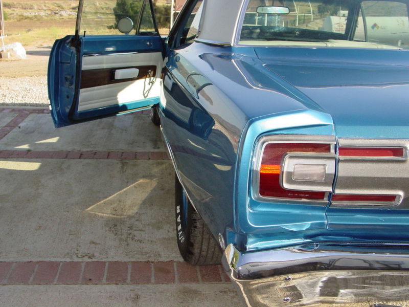

can the trunk lid be aligned better 1/4 panels were replaced,im looking to buy this car if i can fix the trunk lid,

Looks like some funky bodywork is going on on the right 1/4 pnl gap about half way towards the rear deck panel. The height at the back could be adjusted. The thing to look out for is an even gap all the way around. Adjustments can be made for skew, height and sided to side, but the gaps have to be there first. Need more pictures... I look at the rt 1/4 panel bodywork and cringe a little... pretty wavy!
That finish panel can be moved around as well. If it's tilted down on the left side, it will make the alignment of the deck lid look worse than it actually is.

What's really too bad here is the owner spent the money on all the trim, interior, exterior, glass etc and likely cost him a fortune. It's really sad when the body was not done correctly. Absolutely kills what could have been a really nice car... The paint looks decent, in fact looks to be colour sanded and polished.
