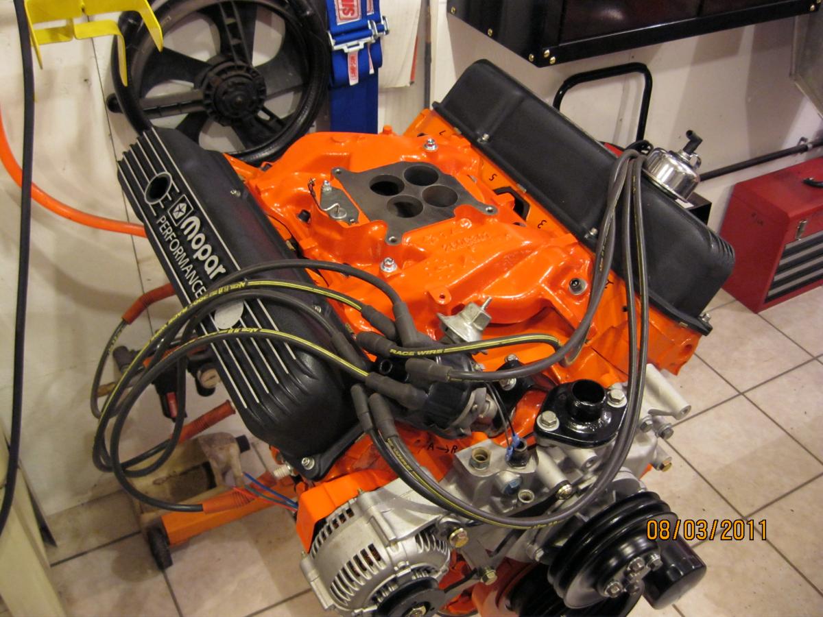

Just have some simple ? reguarding a 383 engine.
1. Do the exhaust manifold bolts require silicone, they look like they go into the water jacket.
2. Whats the opening above the intake for its located between the center cylinders and isnt covered, hole is on both sides of engine. Refer to picture.
3. Why are the engine mount bolts so small in comparison to the size of the holes in the frame and engine mount locations, seems very sloppy.

Sure that's the right intake for those heads?
looks like an exhaust crossover port to me....
I think there is a void or cavity around the actual crossover port that makes it look like its open or not mating up correctly.
i'm curious for someone else to answer your questions though, especially about the exhaust manifold bolt holes.
Because I seem to be burning a bit of antifreeze on my drivers side exhaust manifold on a cold start up after the car has been sitting for a while. (383)
I have been worrying about a head gasket actually.
I think there are high heat silicone rtv sealants that can be used to seal the exhaust bolts. As far as the intake, that is the crossover to heat the choke spring and get the engine warmed up faster and get the choke turned off so it's not running rich longer then it needs to. Why it is open around that port on the head, I am not sure, but maybe it's just to aid in heating the engine compartment?
Anybody else?
I may be wrong but i think the studded exhaust bolts go into the water jacket.And the intake on the 440 in my 70 RR is the same.The hole your seeing is the heat crossover for a factory intake.According to my mopar buddy it doesnt hurt to leave the intake as is.I am sure i will be corrected if i am wrong.lol
I'm sure that the area in question was not meant to be covered by the intake.
Check it out...
seems to just be a void/cavity around the actual heat riser crossover port.
It is the stock intake, and Ive seen pics of the opening still showing on engines, the heat channel is below that area. I do know that the exhaust goes into the water jacket because antifreeze poured out the bolt holes when I had the motor pulled out originally and tipped it sideways. I did see some silicone on the bolts when I removed them but all my books do not say anything about it.
that's pretty awesome for me to hear beacuse i was racking my brain trying to figure out how the hell I was getting antifreeze cooking on my HP exhaust manifolds! lol!!
Betting 99% chance it's a leak past an exhaust manifold bolt/stud.
As Jay said..those are your heat cross over ports.. Some guys leave them open, especially if there is a heat driven carb fuel boil out problem causing hard starting after sitting for a few minutes and they don't have room for a spacer.
Your exhaust manifolds were held on from the factory via studs and nuts/sleeve nuts. If you install bolts, be weary that you will be dumping anti-freeze everytime you pull those bolts out as they do run into your water jackets in the heads, as you found out. High temp sealant usually does the trick to keep a bolt/stud from leaking. I don't know if it's murphy's law or bad luck, but i've always had the big block exhaust manifold gaskets take a crap twice as fast as small blocks, thus I always kept the studs..
As far as the slop in the mounts, what dia. of bolt are they? I'm trying to put an exact size on bolt Dia. from what I ripped out/installed in the past. The bolt heads are 5/8"....Bolt size of 7/16" maybe?? kinda taking a shot in the dark...Anyone elso on bolt size?
So Will do ya recognise the intake lol. Looks different all blasted and painted huh. The bolts that fit into my engine mount are 7/16 but the holes on the car frame are about 5/8 and so is the hole opposite the welded nut on my mount on the motor. Maybe its for movement when you mount the motor in the car. I might go with studs on the exhaust if I can see it working with the headman headers I have. And to the other guy, I can definetly see how a engine would burn through some water with just a non coated bolt installed, not a fast leak but big enough to make you think a head gasket was out which is not a fun thing to change out.
Now Im going to get out my kids art brush and paint over that raw steel area I so carefully masked around for no reason lol.
Wow Russ......That Intake cleaned up beautifully. You do nice work! Glad it went to a good home!
