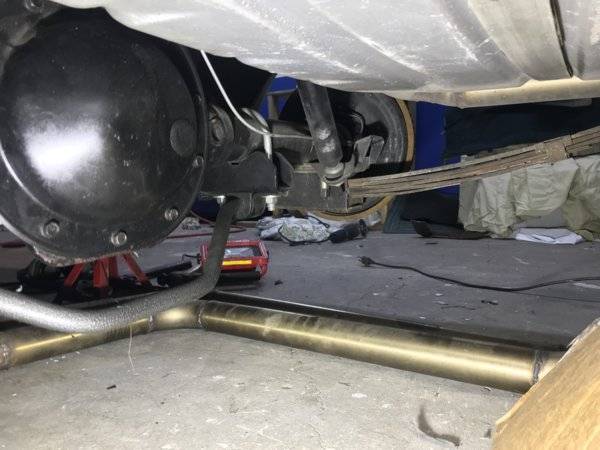

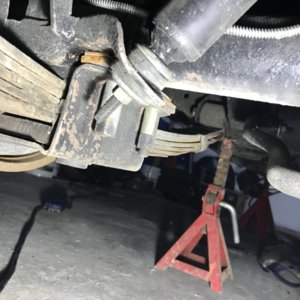

I installed a dodge diplomat 8 1/4 onmy belevedere from a police car , it has the big brakes on them
I made a clean swap with some modified brackets in the back it went well for me
I see if I have pictures at home
