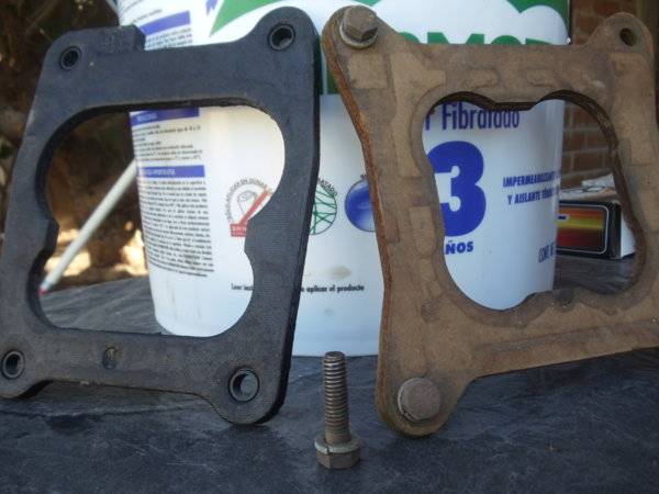

After looking over my parts stash, I found this '68 340 manifold with Carter AVS did have the 1/8" insulator (not saying it was factory installed) with 1 1/4" bolts with "TR" on the head of the bolt. These bolts I have then should work OK. (ThermoQuad insulator on left, AVS insulator on right in foto)

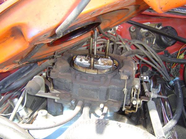

I can confirm as Nacho said, studs and nuts as picture shows. Mine before placement in engine bay.
Click on full image and zoom in.
The question is whether or not bolts or studs were used on small block, the picture shows big block. So was there a difference on hardware for big block versus small block.
