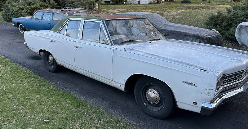

The Coronet and the Satellite station wagon used the same rear doors ‘68–‘70. In this pic of two ‘68 Satellites, you can see the 4 door had matching body lines for the rear door. Same for the ‘68 Coronet 4 door. The wagons had a smooth skin for both car lines.
The Coronet and the Satellite station wagon used the same rear doors ‘68–‘70. In this pic of two ‘68 Satellites, you can see the 4 door had matching body lines for the rear door. Same for the ‘68 Coronet 4 door. The wagons had a smooth skin for both car lines.View attachment 1503318
