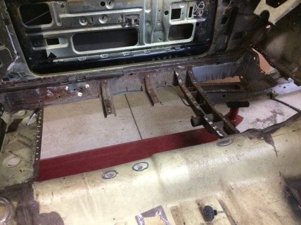

This should be an easy one but I installed a new AMD full floor pan and didn’t think to take seat mount measurements. The holes in the pan are a few inches too wide from the seat rail studs. Front and back looks good.
AMD says there pans are set up for buckets. Anyone have layout dimensions for a bench? The car is a 68 Coronet, thanks

Have a funny feeling the AMD pan needs holes drilled into it for a bench?

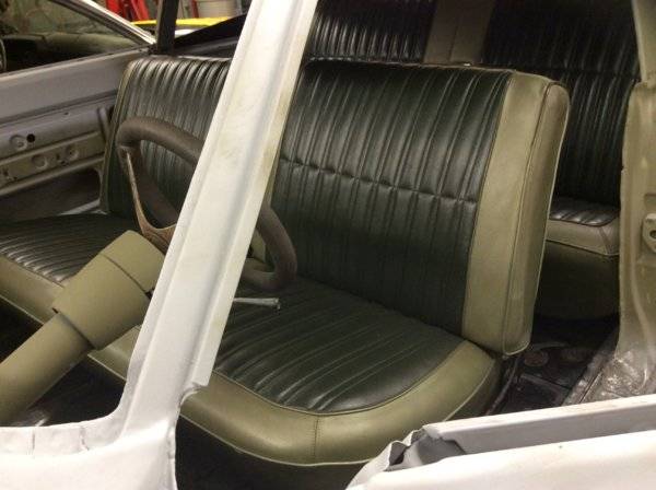

Maybe that's not an original bench seat ?!?!?
The interior is out of the same year Coronet 68. Rear fits perfectly, seatbelts correct year on the tag, front side to side seems to fit the width. In the pic it’s slid over some towards the pass side. The guy I got the interior from is restomoding and saw the car it came out of. It’s definitely a 68 Coronet. Not that doesn’t guarantee it’s 100 percent correct.

Yes the brackets under the pan. Once I drill through the floor pan looks like the right pattern. I am getting to the end of the build and replaced almost every piece with AMD stuff and the obvious got me. I am assuming the holes in the brackets are where the bench studs go?
Thanks

Seat installed, amazing the brackets lined up perfectly!
