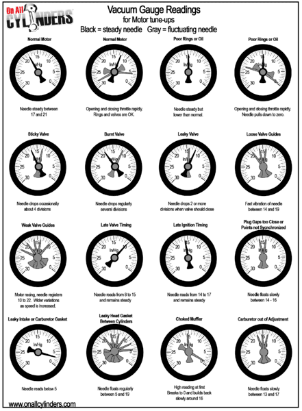

I wouldn't call those numbers "all over the place". you just need to look at the 2 that are down. is the vacuum gauge steady at 13" or is there some fluctuation?
Thanks. The gauge dances around quite a bit. Ive had a few vehicles in the past that the vac stayed dead steady, this is not one of them lol.

Search for vacuum readouts. Here's one that I found. Give symptoms of engine based on what vacuum does.
