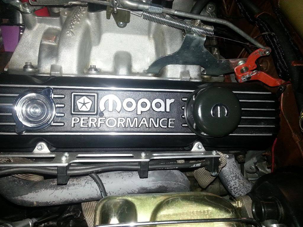

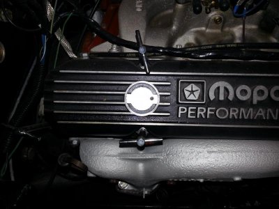

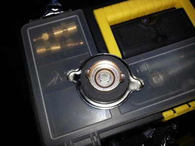

Looking for a set of breathers for Mopar Performance valve covers I bought off summit. I got a set from them but they are generic and cheap and leak oil out of them due to poor sealing. The dimensions of the hole are 1-3/16 and 1-7/16 for the slots heres a few pics of the covers and the caps that came with it. 20140208_193525.jpg20140208_193508.jpg

I don't know if it helps, but most guys I know that run those VC's,
use a "universal" type breather.
the breathers come with a couple different size rubber grommets that you fit to the VC and push the breather in.
Ive used them on several styles of aftermarket VC's before.
I kinda looked into that but I wasn't aware they came with different size grommets and couldn't find one alone to fit the hole size a lot of those style say they dont come with the grommet. Where do you get them at summit or similar?
I'm sure most speed shops carry them, you can also buy just the grommets by themselves iirc, I think the last set I bought I got at an auto parts store in the performance section.
Yes run the Mopar performance breather, I painted mine cuz it comes in chrome. You will have to drill out the spare hole oin the cover but that is easy. I use PCV on the other side.
The small block gasket kit used a cork gasket that is much thicker and the cap fits snug now on mine. The cork gasket was used for something else and was left over.
Thanks for the info. Bigman where did you get your breathers at?
Your welcome! I ordered mine threw our dealer we get collison parts from at work.
