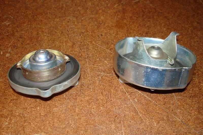

The original cap for that application was non-vented, however it did have a pressure/vacuum release valve incorporated into it. It does appear the Stant 10571 is the locking version of the original non-locking cap(or Stant 10807) and should have a vacuum/pressure release valve, I believe that’s what you are seeing.
10806 left, 10807 right;
Wait, how is original cap non vented, but have pressure/vacuum release valve?!?! What is the purpose of that valve?

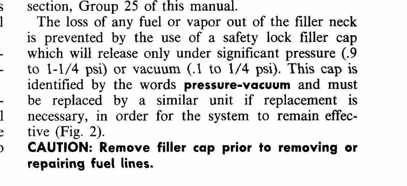

I will let the FSM explain the function of the cap vacuum/pressure relief valve;
As mentioned, the tank is intended to be vented through the fuel tank vapor separator and charcoal canister. Sounds like you have removed and plugged it all off. The vacuum/pressure relief valve will not act as a substitute fuel tank vent.
