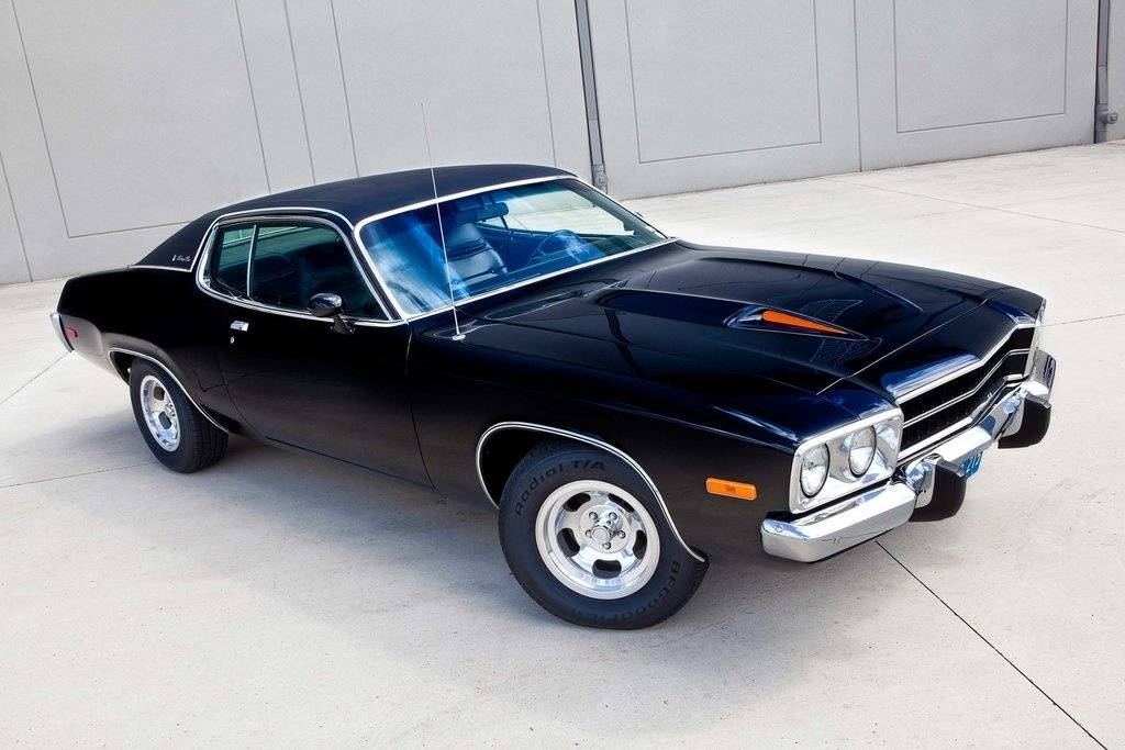

What was the factory color on the inserts? The orange-y paint has faded on the inserts in the hood I'm going to restore.

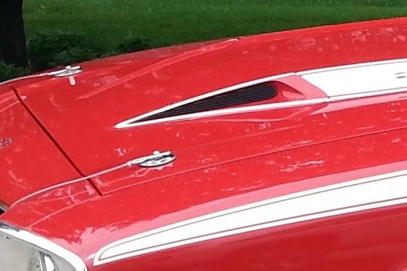

Also, I remember seeing a thread somewhere on some board from someone who put chicken wire in place of the inserts, to let cool air in and/or hot underhood air out. Anyone have a link to that?

The elongated tear drop part of the insert is black, all cars were black, never seen them any other color from the factory. I restored mine and powder coated with 20% gloss. I believe originals were either flat or satin, you can do a low gloss, which makes them easier to clean, flats are not fun to clean.

That was my car. I removed the small inserts, cut the rear section out of the back of the larger insert, and then put heavy-gauge mesh that was painted orange (the hood was black) into the cut out area. Then I mounted two amber lights just above the mesh so when I turned them on at night the inserts would glow like they were on fire. :)
I then made a sheet metal plate (made from the side of a surplus Navy desk) with hole in the center for the carb horn and a rubber seal around the outside that sealed against the hood when it came down. The plate had the air cleaner filter on top of it and was held together by the top of the air cleaner. This meant all the air being pulled into the engine came through the hood vents.
