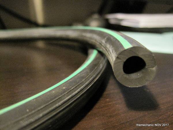

Let me clarify, the one the PO had on the car. I replaced it when I added an overflow tank.
I'm not saying this is NOS. I'm saying it is what the previous owner had on the radiator when I bought the car. It has a green stripe and 3 thin ridges running the length of the hose and the hose is really thick.
Cool looking hose but not original. The original is thin walled and has ribs. Frank Badalson offers a correct new hose.
