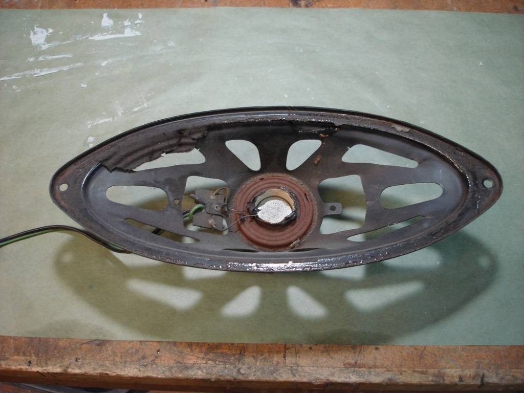

Searched with no exact answer found. Is it a 4x10 that fits the dash of my 71 Satellite ?

I was indicating only that the original single 4x10 speaker, used in ’71-74, had a unique mounting pattern that will be hard to locate a direct replacement from aftermarket world today. Will either need to trim away ears and/or add mounting ears to the ends.

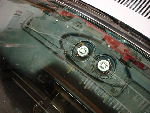

Most will rework the opening or original frame to accept a pair of 3 ½”.
Okay. Thank you. I'm sure I can make an aftermarket 4x10 work. My dad's got a bitchen set of tools. :D
I see the speaker drops in from the top. I think a modern speaker will be an easy swap.
