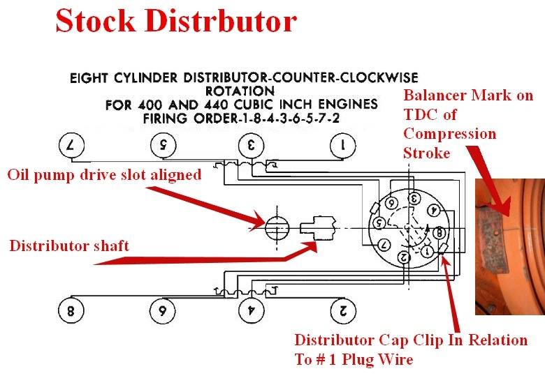

The slot in the gear should go front to back. Note the position of the flats on your gear shaft. Now use your priming tool to and turn so flats are in same position as what your gear would be. You may have to make minor adjustments but gear and shaft should rotate in position.
Use a large hammer and drive it home. Whatever breaks first must have been the problem!
Texas69bee is right the slot be straight front back . Need to have number 1 cylinder at TDC firing position. I use a large long handled screw driver. The slot should at say 1 o'clock when drop it in. then turn clockwise it should be close. If it ends up at 4 o'clock turn it counter clock until it jumps a tooth then turn clockwise again.
