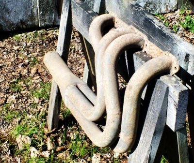

Would they look anything like this? I just know that these won't fit my road runner.
Actually I"m looking for the "over and under" fender well headers. what them to spit out straight down behind the front tires. thanks for the pic though. I really appreciate it!
