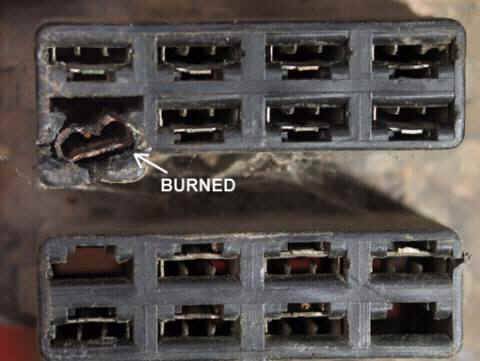

AND..............check the bulkhead connector ITSELF. These are becoming a really bad problem for some guys. If the terminal inside gets loose/ corroded, it HEATS and this conducts heat to the (fuse) wiring next to it.
Read this great article on what happens:
http://www.madelectrical.com/electricaltech/amp-gauges.shtml
from the article, a fried bulkhead connector

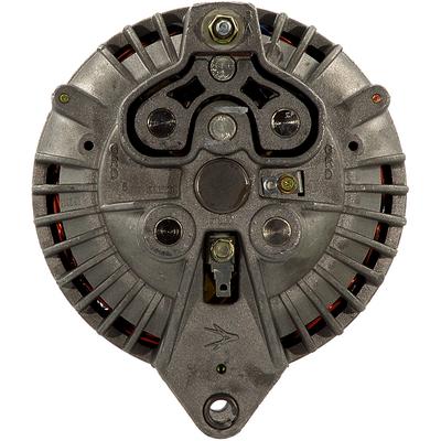

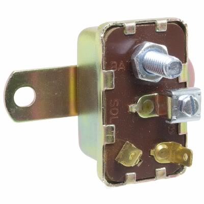

I found those guys at MadElectrical.com years ago, great knowledgeable people, great parts, connectors, wiring products, automotive electronics supplies, relays, pre-wired connectors, schematics/diagrams too, be very carefully taking them apart they tend to really brittle, I also would highly suggest you use a brass or stainless, wire brush's, pipe cleaners or what ever you have to, to clean out both sides of all connection & when reinstalling add a dab of dielectric grease on all connection, it will help to keep moisture out & good conductivity... Also check all the connection, at the big black wire under the dash that goes to the "amp gauge" 1st & branches out everywhere, main power feed for everything, you can run a #8ga or #10ga wire from the main 12 volt charging 1/4" threaded post on the alternator, to the main large 5/16" threaded post on the starter relay on the firewall it will shorten the path for the charging system & relieve some of the load on all the bulkhead connections & especially the "amp gauge" connections that supply everything... Good luck, Electrical problems are a real bitch sometimes...
