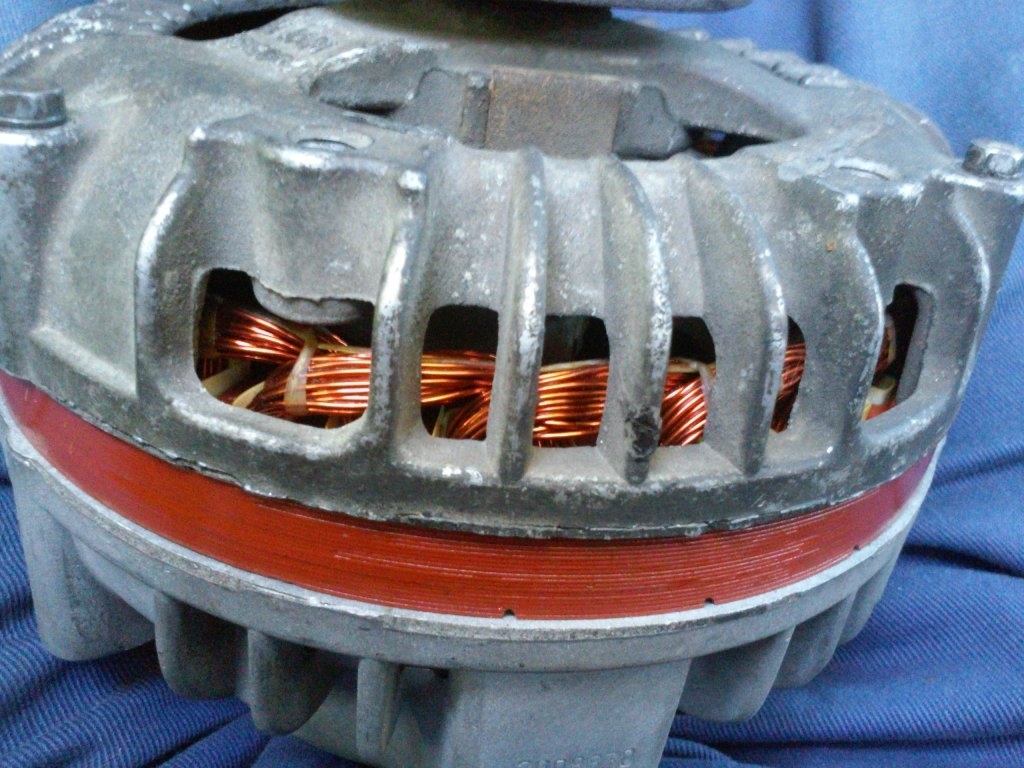

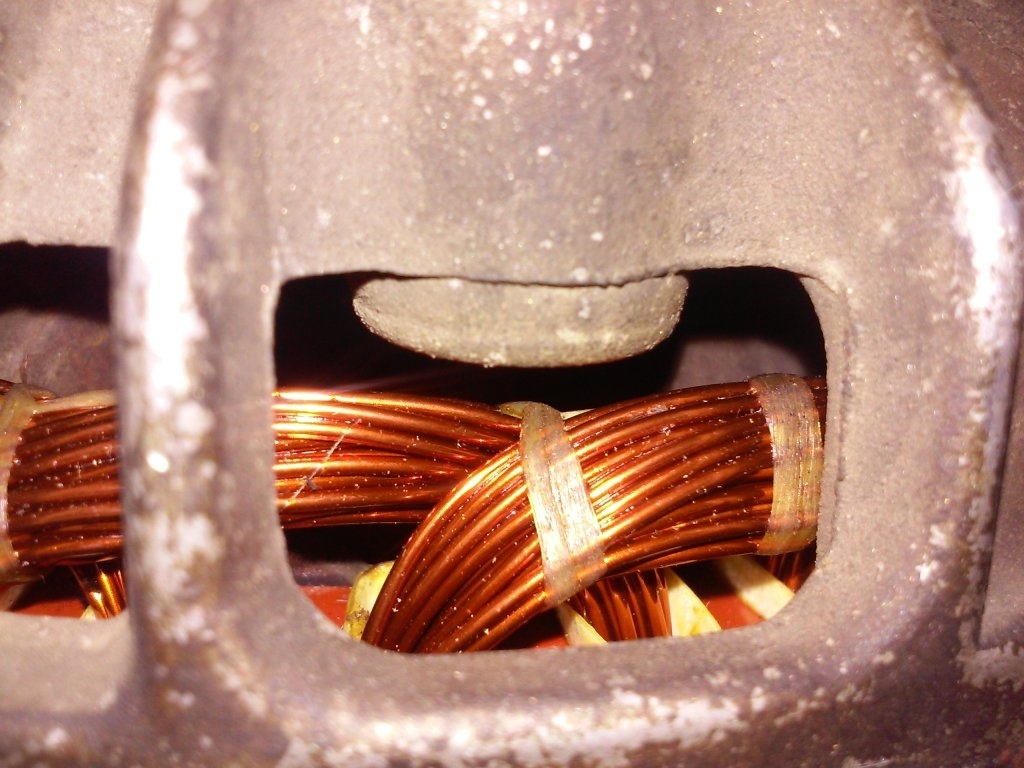

Used local shop to rewind a stator.
I think he paralleled two 18 gauge wires in each leg of the wye, and made each pole grouping have 15 turns.
Should really honk at idle.
Maybe tomorrow morning.
This should decrease field current quite a bit, and decrease VR point wear and sticking as much less field current should be called for to provide same output.
I will report how it acts, and he agrees to wind these by hand for anyone who might care.

After one day of testing, I am very pleased. I am not overjoyed.
The reduced field current has stopped the contacts in the mechanical voltage regulator from having a tendency to stick together, and I no longer have the flaring light syndrome, even with the same old regulator that seemed "prone" to sticking.
Idle at 700 rpm in park, supports headlights, fan full speed, and brake lights without going into D range.
I think it could be even stronger with the field portion of the alternator I took off, as there are different field windings.
Plus that alt has a smaller pulley for higher RPM, maybe tomorrow I will swap fronts-n-backs.
Compare to old alternator stator wires, only 9 or 10 per loop.
