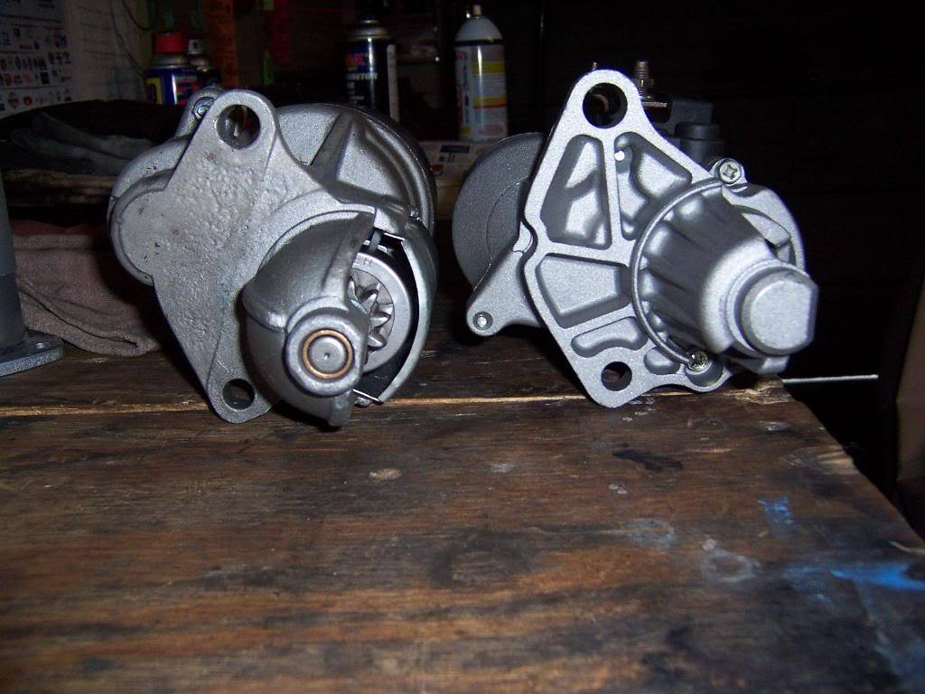

So,I went to put a '91 Dakota/360 starter on the Sport Fury,cuz da headers hit on the OEM big-*** starter. Got it into position and...it won't seat! It seems that the nose(?) hits the inside of the trans case,and the solenoid contacts on the block.
A comparison:

Been there & done that:puke:There are 2 mini starters,one for the small block and one for the big block:munky2:I found out at the track,ended up grinding the starter to fit,started to break through the starter surface when it got paper thin.Musta had the starter in & out 10 times before I could yell "BINGO".Did get it fit after 1 1/2 hours and it lasted many years.ALSO,loose the plastic piece where the heavey positive cable .If the budget is tight,start grinding.:tongue8:

BINGO!!! HEMI-ITIS;you were right on. I removed that plastic terminal addition,and it went RIGHT IN!!! No lube required! Now I just have to figure out how to get it and the header on at the same time-the header still won't clear the starter when it's in place. But,it's a start(-er)... Bad,real bad...
