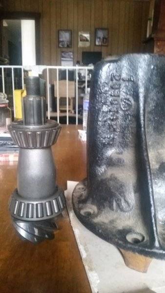

489 pinion 742 case
People told me I couldn't put 0.060 over 340 pistons in my 360 small block 30 years ago too. They also said I would never get it to run on pump gas or with an 850 spread bore with 12:1 compression and 0.630 lift
I'll type this up to be more presentable and include the rest of the necessary info on how to do it later. Sorry for the crappy photo

I had a 9 1/4 with 391 gears and a posi. I found an 8 3/4 from an A body that I welded new spring perches on at the pinion angle that worked best for me. I run the 8th mile and wasn't getting out of 1st gear with the 391 after figuring out how to get traction. I came across some Richmond 513 for the 489 for cheap so I bought the 489 and somehow it wound up scrapped. So started my quest to stuff them into the 742 because I read somewhere between year changes Mopar was swapping gears between cases. After much bearing searching I bought the bearings, got the pinion depth set tried to assemble it and found out it wasn't that simple. Anyway with the right shims and bearings it can be done. It wasn't until recently I came across a 489 case for the right price and took it all apart to compare measurements.
