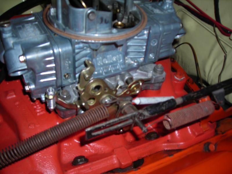

I recently posted a question about a missing piece that would make my new Holley carb work with the original throttle linkage. Thanks for all your help. I ordered the 20-7 bracket. Keep in mind that I don't have the car to look at. The 20-7 has 2 holes to bolt to the carb lever, and it has one more hole for the throttle cable.
But I think the kickdown is a separate cable. How does the transmission kickdown cable connect? Does it go right with the throttle, or does it connect somewhere else on the carb?
I can't find a good picture of this anywhere. I need to have the answers because my mechanic experiments and learns on my dollar!

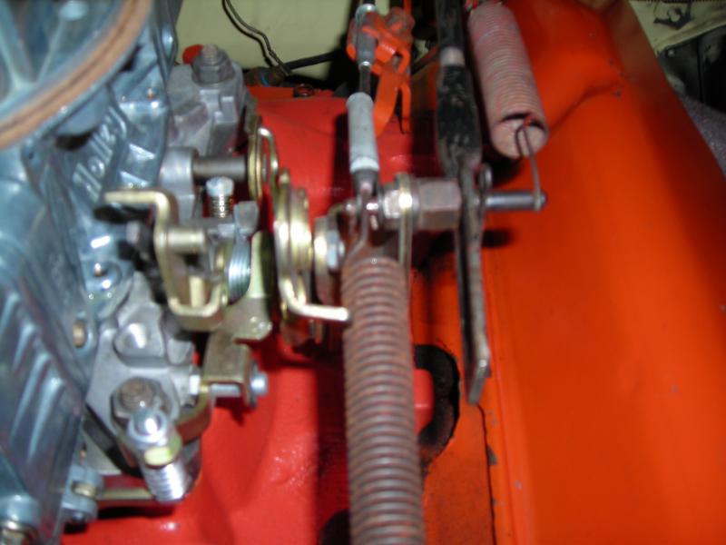

I used to have a Holley on my car but went back to the AVS. If you have Holley/Mopar adaptor on the linkage, you need the factory stud for the linkage.
Here is how mine looked.
