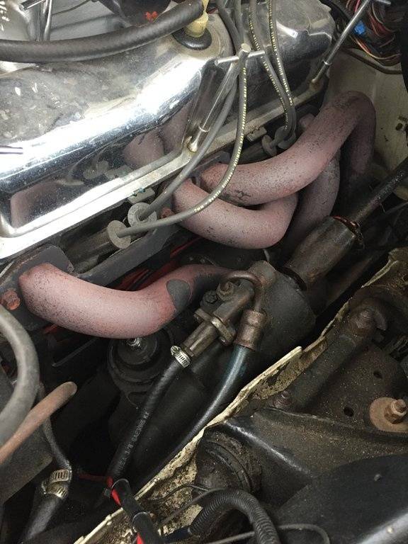

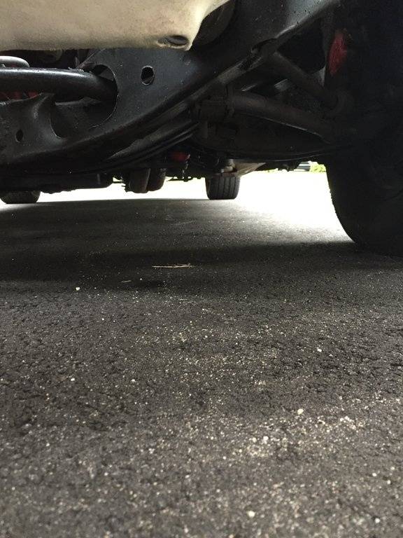

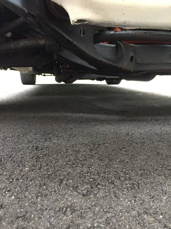

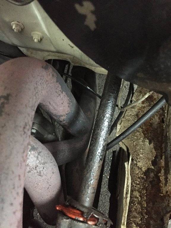

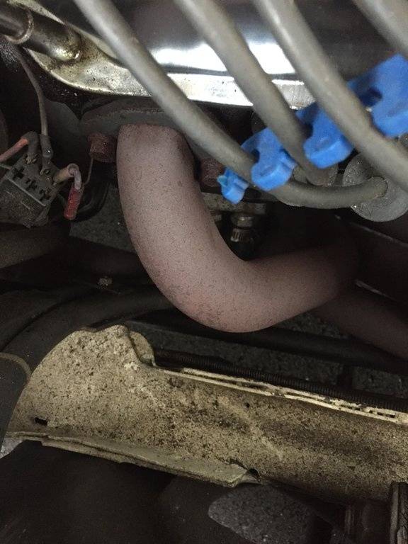

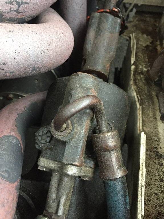

I did not have to dissemble the front end linkages and none of the pipes are under the steering linkages. My photos show the underside of my Magnum. It has a console shifter. The OE kickdown linkage is long gone. Lokar cables are now employed.

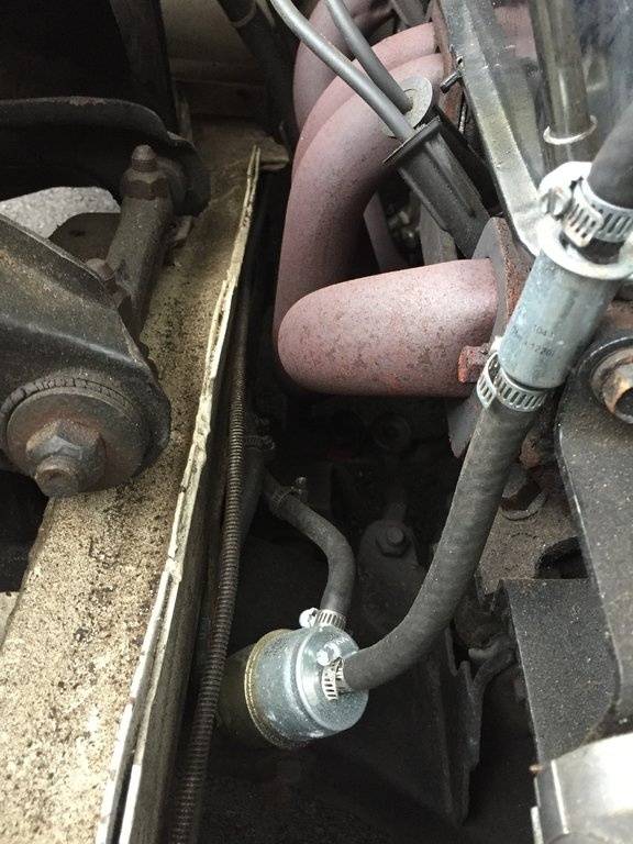

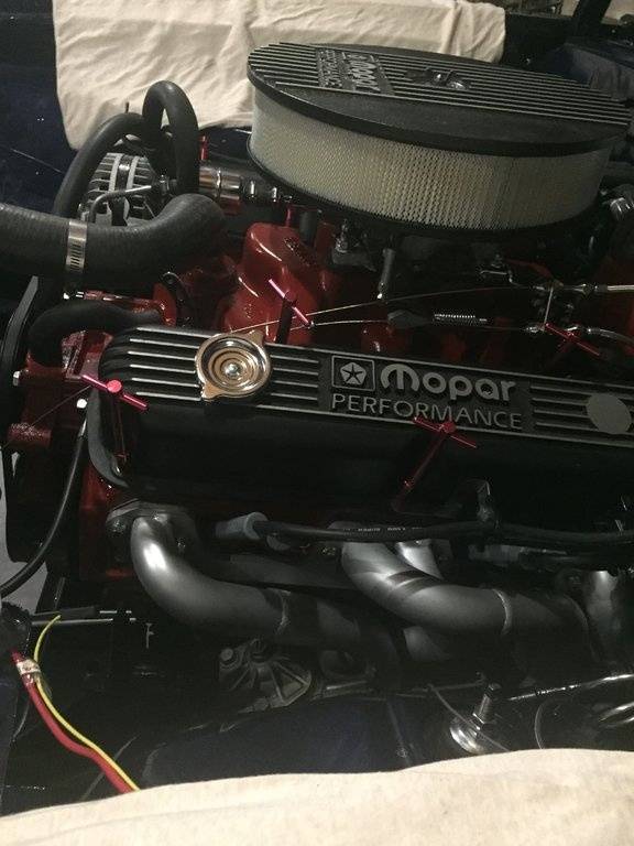

Below are TTI no problem with clearance headers. I do not have a shot of the super Comps. There EZ as well.

Fitment wise, the super easy Hooker Super Comp headers. You may not be in love with the 1-3/4 tube at IIRC, 36 inches, BUT there is no fitment issue, nothing below the linkages up front.
View attachment 505902 View attachment 505903 View attachment 505904 View attachment 505905
WOW! Thanks so much for sharing this information. The Super Comps fit my satellite SUPER easy. Granted I had the car on a lift, but snaking them up through from underneath took about 5 minutes. No swearing, no denting to fit, no pickle fork or air hammer. I was able to just hang them on the studs at the ends of the heads , then tighten them up from above. I was dreading it all day, then couldn't believe how easy it was.
