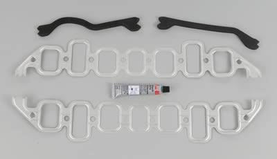

I've installed intake manifolds before and tossed out the front and rear foam/cork seal and just ran a thick bead of Ultra Black. Seemed to be easier to deal with because the seals sometimes move when you're laying down the intake.
So I was thinking, maybe 'glue' down the end seals with Ultra Black and let that set up, then run a bead on the top and lay down the intake.
What do you guys typically do? (I have a different gasket set, not this one with the metal gaskets). Thanks!

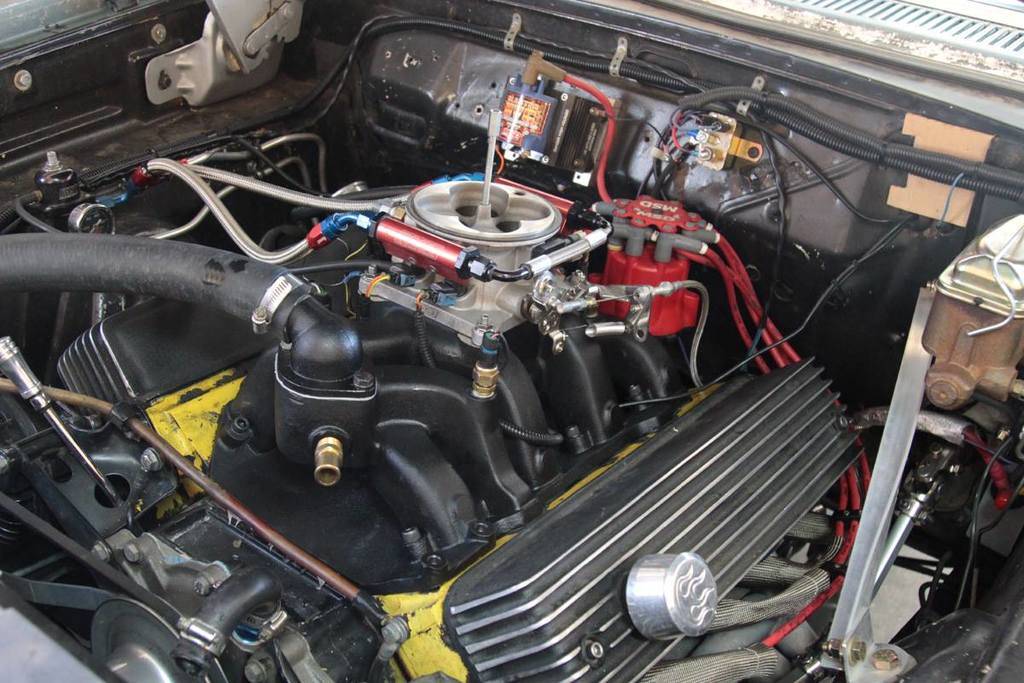

I've had success with the Black, and I'll probably use that next time because I wasn't real fond of the Ultimate Gray, at least not for an intake where you have to adjust it to line up the bolt holes. I haven't tried it anywhere else, but I'm not in a hurry to do so, either. I like Ultra Gray for t-stat and timing cover, but the black for the intake ends, at least on a V8, anyway. And yes... that's a Poly with Roland's Intake Manifold.
