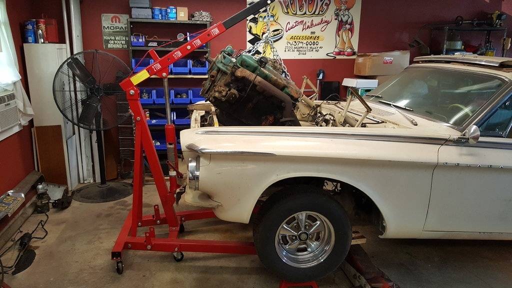

Invested in a Duralast cherry picker and plan to pull the 318 from my '72 SSP project car today. This two ton rated cherry picker has four adjustable extension settings: 2 ton, 1 1/2 ton, 1 ton, and 1/2 ton. All the way extended is 1/2 ton and the hook just barely reaches the carb pad at that setting. According to the charts, the small block weighs in at 525 pounds. I guess I better at least remove the exhaust manifolds so I don't overbalance the darn thing.
Try pulling a big block with tranny! My HF crane is probably built on the same Chinese floor, but it hoisted my old iron headed 413 and trans no problem.
Don't worry about it I pull big blocks on the lightest setting
You will have better reach with the cherry picker if you go from the side, just have to remove the tire, and should be able to use the 1 ton setting if you are concerned about lifting on the 1/2 ton setting. This only works if you are not pulling trans and engine at the same time.
Just make sure the legs are extended at least as far as the hook, more if possible.
Motor has been extracted, never thought about trying it from the side. The legs protrude about a foot past where the hook is hanging.
I think, considering the situation, you rent a heavy duty picker with longer reach and capable of more weight. This is not a place to gamble with "here say" unless you got a $hit load of spare parts. " Always time to do it twice, never time to do it right!"
The reach was just enough for extraction, hopefully I will have enough wiggle room to get it installed again. I taped some cardboard to the chrome front bumper just in case it rubbed.
Hood off- good guess KK!!!!
I have the engine out here on the garage floor and it is DRY everywhere above the circle of bolts that connect the transmission and engine. I wish it were a valve cover!
I have pulled the 426 Hemi with A/C out of my RR with a Harbor Freight 2 ton cherry picker with the boom set at the 1/2 ton setting with not problems.
Remember most all of the cherry picker Brands are all China made. If I remember correctly they must have a 50% over weight safety factor.
^^^This for sure.^^^
You could add some ballast to the rear of the hoist if you find you're at the over center tipping point. Maybe beef up and lengthen the boom extension a whole 3 inches longer?
Lift the rear of the car to ease the angle.
