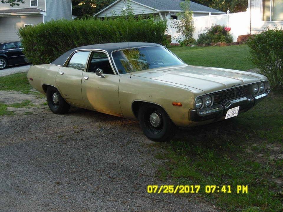

Hey All:
Just bought a 72 Satellite four door. It has an 8.25, but I want to replace It with an 8.75. Anyone know which cars I can use for a donor without relocating the springs or perches? Am buying new wheels so if the axle ends move inward it doesn't bug me!
Thanks!
Steve
look for one from a 71 or 2 b body for a easy in and out swap
guys will fit e body ones in for more clearance
but that requires changes with other parts
like new relocation spring hangers.
