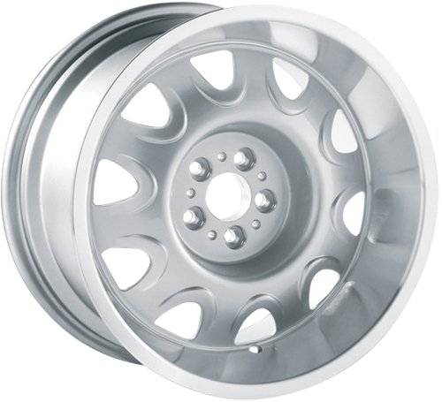

I usually wouldn't recommend this but the 71-72 B-s have such fat fenders that the billet rallye wheels actually look pretty good on them. I think they come in 17 or 18" sizes so you can fit a taller tire and fill up the well.
I would like to go with a bigger wheel on the back, but you can't get raised white letter tires in the larger wheel sizes, and a B body without them just doesn't look right to me. :)
