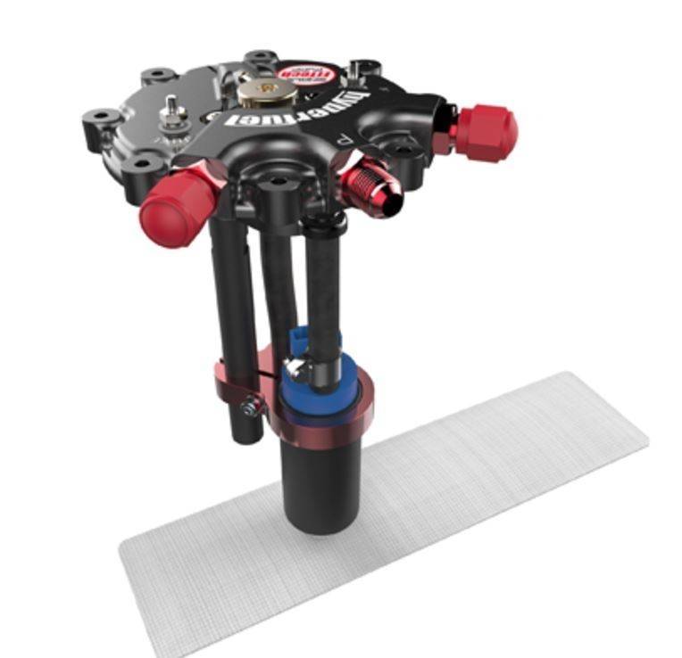

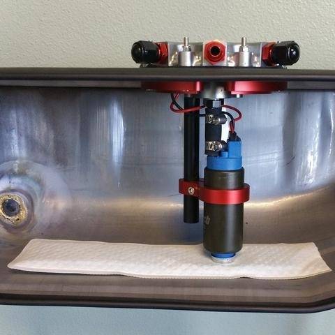

Hey here fellas. Pulled the trigger on the fitech EFI - super stoked - should be here soon. Decided to go with their in-tank pump kit (they call it Hy-Fuel).
Anyone have any ideas on how to permanently lower the tank for clearance? The kit sticks like an inch above the top of the tank.

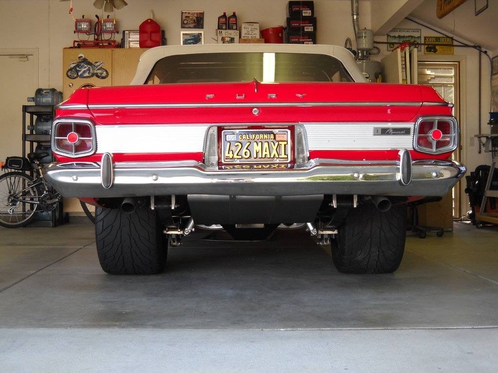

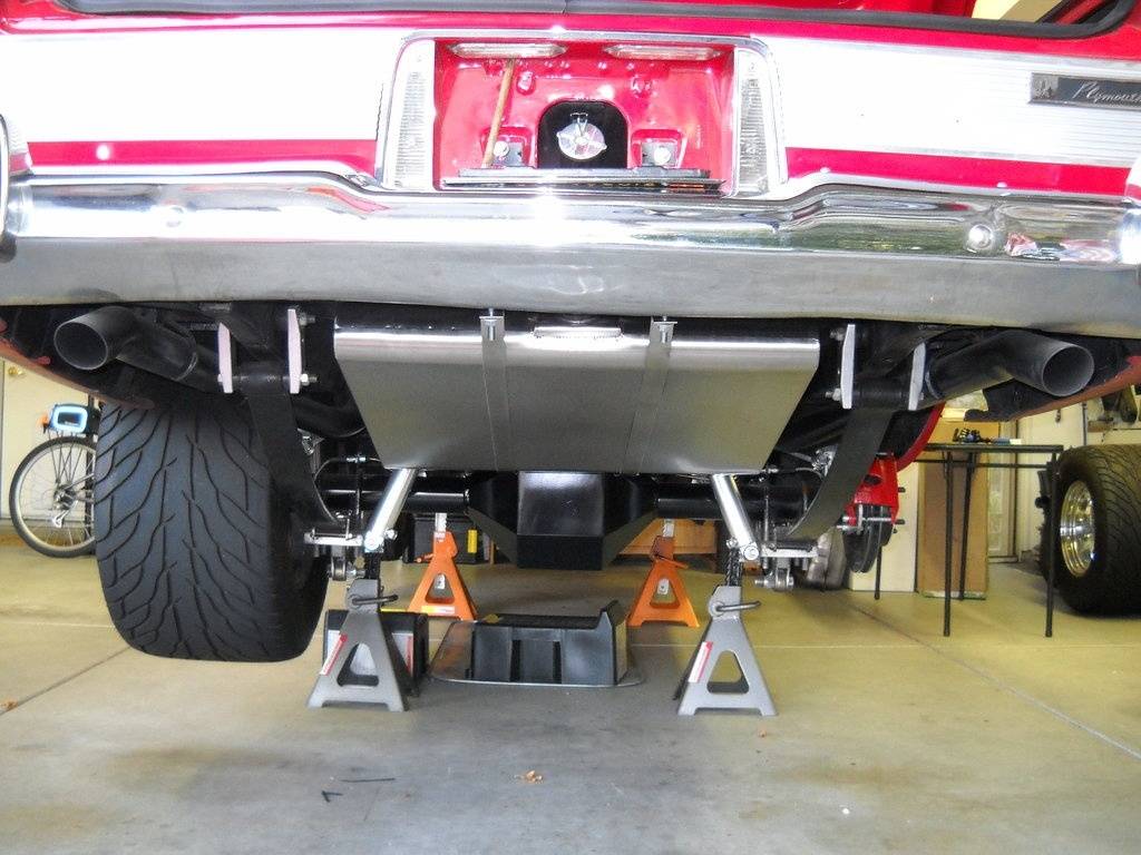

They didn't make one for 67 cars, so we bought the tray, and grafted it into the tank. Turned out very nice.

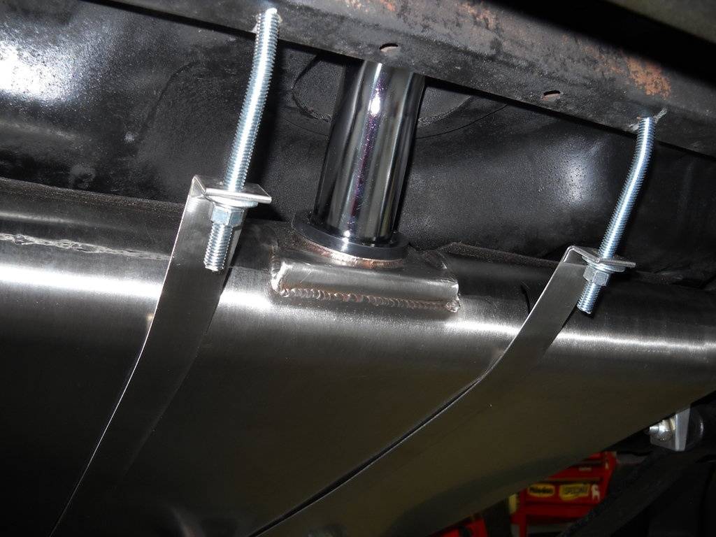

Dan (HT413), Here's the new S/S tank with an in tank pump and the vertical tube sending unit from Rick's Tanks in El Paso. They custom made the tank to fit my 63 Fury. Expensive, but great quality and fit just right.

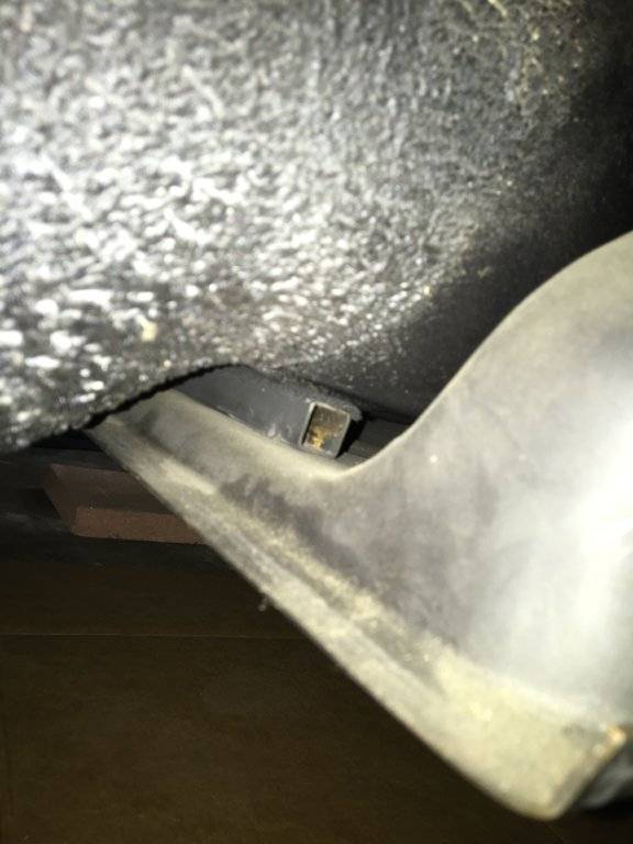

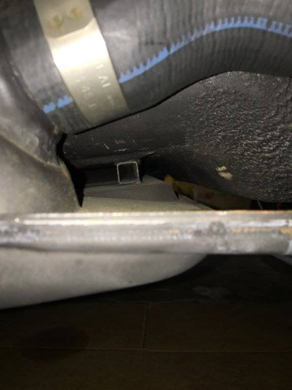

i tacked welded some square tubing on the top of my tank to shim it down just enough so that the fuel line fittings and fuel sender connections did not rub against the trunk pan. i tossed a few pieces on different areas so the tank shimmed down evenly
that rubber mat would work just as long as you use it to shim down the tank clear fittings, lines, etc. from the trunk floor
your OE tank straps would probably work but you may need to make a longer hook - go to home depot
