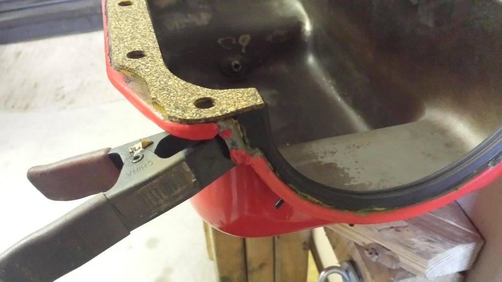

On my 360, is there any sealant on the rubber end seals of the oil pan? I know to put rtv where the cork meets the rubber in the corners but not sure about where the rubber seals meet the curved surfaces.
Always used "hi-tack",gasgacinch, indianhead myself. Plus the rtv at corners like you said.
I have used Permatex High Tack on the cork and rubber cement on the end seals where it mates with the pan. No sealant on the block.
