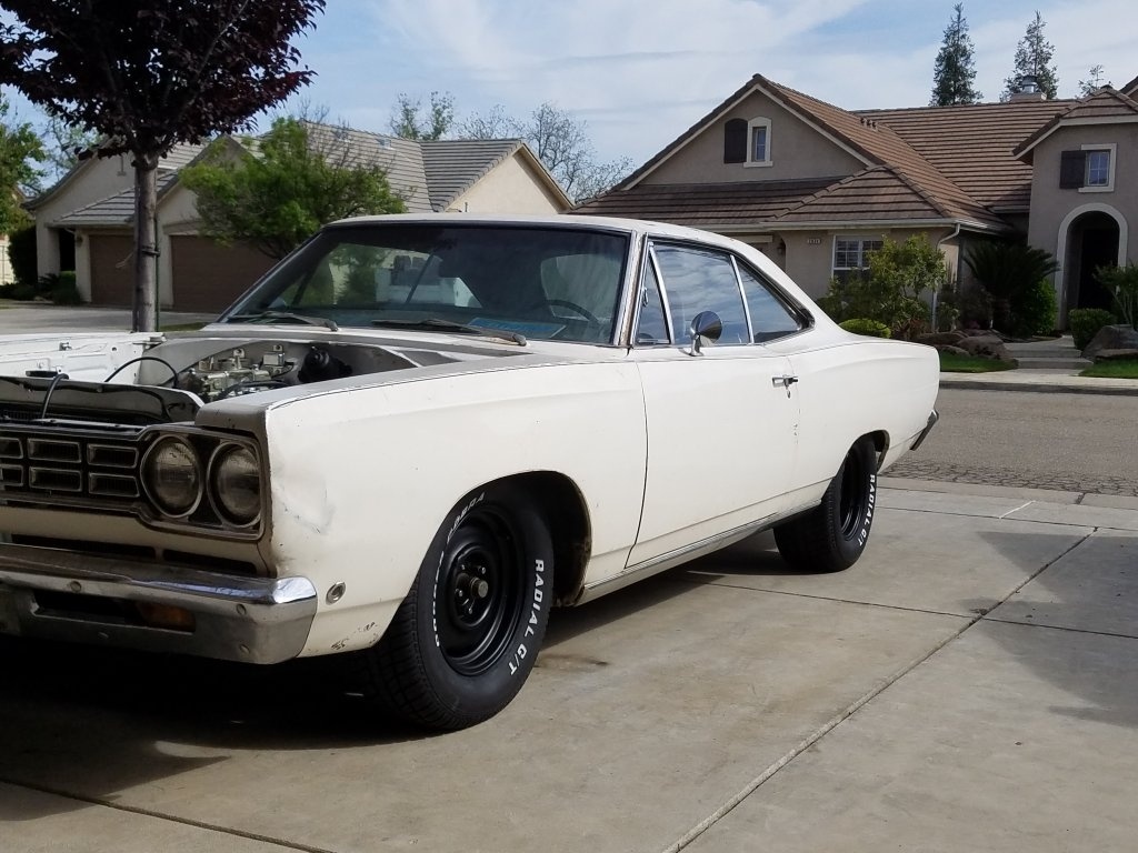

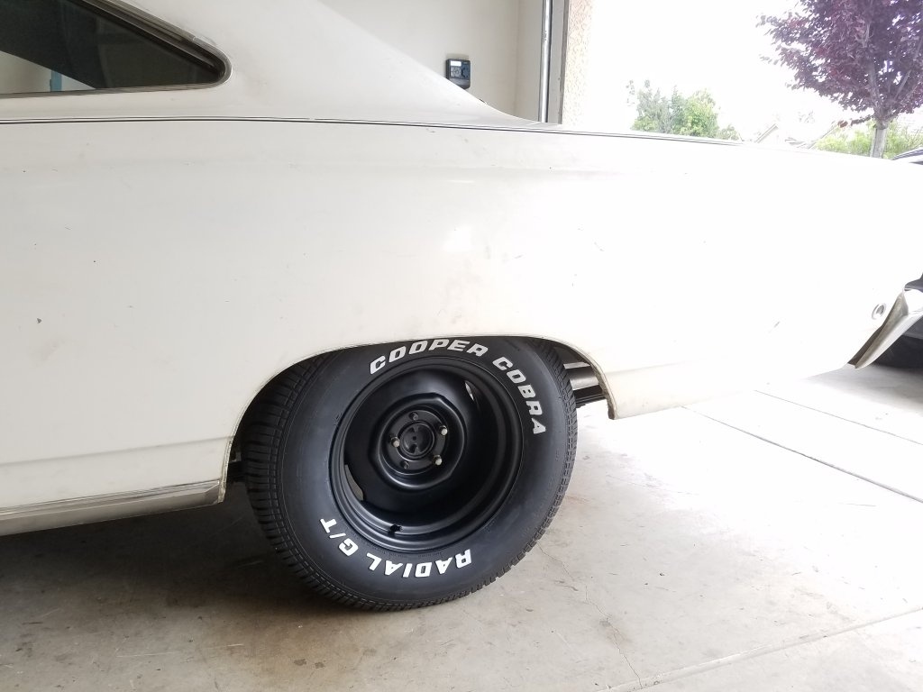

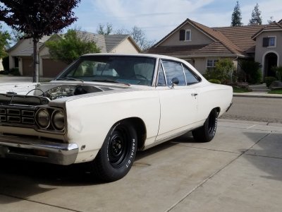

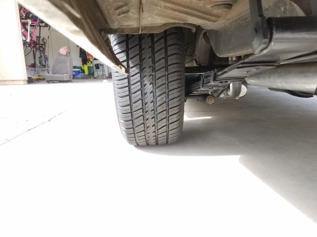

Here's my 275/60/15, 4.5" backspace on an 8" rim....4.75" would have worked, 5" would be too close to the springs.. fits nice but not too much more room in there. A member here Dennis H runs I think a 295/50 safely, look him up there's pics of his. Any bigger you might need to roll the fender lip, and don't go much taller or you run into the hump in the fenderwell structure, depending on how much height your springs will allow. I have the XHD springs which sit me down the way I like in the back, some springs like SS lift up the rear a little more and you can fit a taller profile
