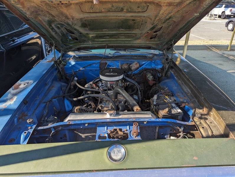

Good morning folks, this is my first time posting on FBBO. I've lurked on this sight off and on for a few years, but I finally decided to join and start asking some questions. I have a 1972 Plymouth satellite Sebring with a 318 LA and a 3 speed 904 transmission. I believe it is numbers matching(not that anyone cares lol), and I don't think it's ever been rebuilt. I've put a decent amount of work into the car to keep it on the road, and I've been driving it for the last few years. I'm getting out of the Marine Corps and moving from southern California to Wisconsin in December, and I figured it was a good opportunity to run it up route 66. I want to build the engine and transmission before I embark on a 2,000 mile journey and end up stuck in the middle of Utah with 7 pistons. I've rebuilt/replaced just about everything that I can bolt on to the engine, but I've yet to tackle the valvetrain or rotating assembly. I know the car has been run out of oil once (oil pump shaft sheared off on a healthy acceleration)and overheated a few times (someone installed a block heater before I bought the car), so I'm fairly certain I'll need to bore it out a bit. I've looked a few things up and it seems like most people tend to chuck the 318 in favor of the torque that a 360 offers, and I'm open to any suggestions. I want to switch over to a 4 speed manual transmission if possible, but I have no idea how that would work. I've heard rumors that these 318's can be stroked to a 390, but that sounds like it's more of a novelty than a realistic plan. If anyone knows of a good shop in southern CA, or has been here/done this, I would love to hear what worked for you. I'll attach some pictures of the car and engine for reference.

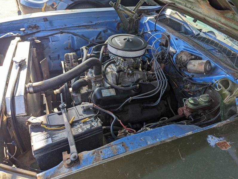

Timing chain did in fact go, that was one of the early repairs. The plastic teeth cracked and fell off into the oil pan, which is what plugged the oil pickup tube. I ran it for a few miles before I realized what had happened and shut her down, not actually sure how much damage I did to the engine.

I have some noticable lifter tick on the driver's side, and what I assume is some rod knock. I had the oil pan off when I replaced the oil pickup tube and pump, and I could physically shift most of the connecting rods a bit on the crank, they wiggled around a bit when I poked them. Not sure if that's normal or the bearings are worn out. I replaced the intake when I upgraded to a 4 barrel carb, and I noticed some of the lobes on the camshaft were chipped, which is a bit concerning.

It sounds like you need to go through the motor. You want to make this trip!! You might be able to just hone the 318 and maybe polish the crank... see what you have.
Most the 72 318 cars have 2.71 in a 8.25 rear. That is already highway geared, ready for a road trip. Simple to check and see what you have.

That does not sound great, but then again I have driven 318 cars with ticking and low oil pressure for 10's of thousands of miles beyond what would be considered poor condition. Key indicators of just how worn things are for you would be your oil pressure and a compression test.
Your car likely came with a 8-1/4, but could still have an 8-3/4. The 8-1/4 could go as low as 2.45. For the 8-3/4 the lowest numerical ratio is 2.76. The difference in revs on the highway from say a 3.23 gear is pretty significant.
