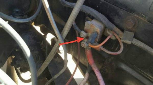

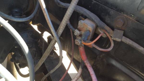

I also have a B Body, but was hoping that this was general enough to cross over. I went to swap out a starter relay and as soon as I touched the nut on the main stud, a piece of cardboard with a slot in it dropped to the ground broken. It looks like it was meant to separate some items from contacting each other. Does anyone know which wires this cardboard was supposed to separate?
If there was something there, it would have been between these two terminals. (Red arrow) If you're replacing with a new one don't worry about anything between here, just don't let those two touch one another.
No problem. They are the two terminals that you can bypass the ignition. Touch them both together with a jumper wire and the starter will engage.
Or you can just do the lazy-*** method with a screwdriver (like lazy-*** me does)
