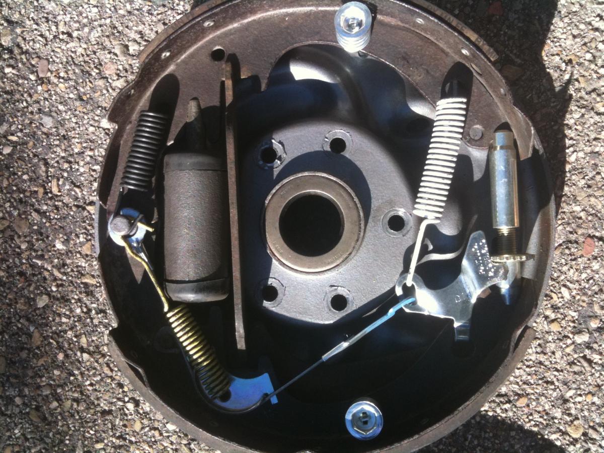

There is no seperate hub, the drum is a one peice unit. Here is a pic with just the drum pulled off (and the brake hardware not yet installed.
The only other thing to remove is the backing plate, which you can also see with the hardware installed.

How bout a couple of pics of both sides of the drum? Exactly what fits on the axle? Is the drum totally one peice?

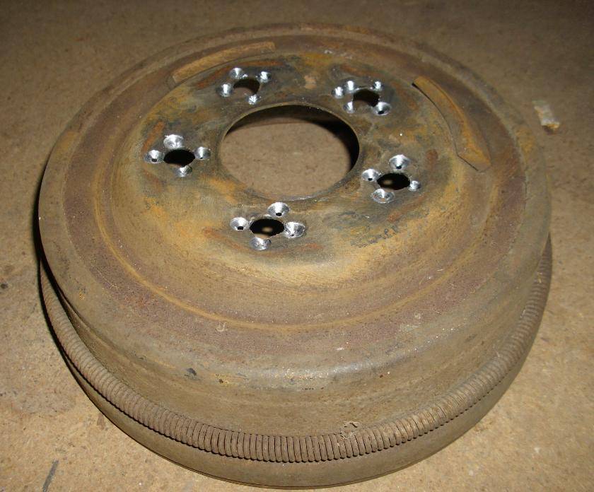

Drilling wholes (not to deep, not through the drum!!) around the studs.
Install the complete Hub and Drum again on the axle, incl. the big nut.
Than I used a puller around the drum and it was easy, to pull of the drum from the hub.
The studs are allright and now I use a Ray Besto 10 x 2 1/2 Brake Drum. It's a standard part, you can get it on amazon.com too!!!
The wholes are a little bit taler than the old ones and it fits perfect!

That's what I did:
To take away the tension around the wheel stud, I drilled holes near the areas where you can see the pressing.
You have to be carefull! I tried to drill not to deep, that the hub will not be damaged. A few holes are a little to deep, but I think, that's O.K.
After that, you will see, you can move it a little bit. If not, take a second drill, a little bit larger, at the studs where you can't feel that they are still tight.

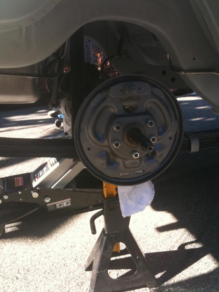

Than take a puller (this Picture is without the holes, only to show. I forgot to take one, at the other axle!!) And do this with the big Nut on!!!!!!
The drum will be rubbish, after that, but this one is a perfect replacement (10 x 2 1/2 inch!)

grind the studs a little bit and remove the rests from the pressing.
The Raybestos drum will fit perfect.
And next time, you can pull of the drum, like at the later models.
If you want to make it absolutely perfect, take out the axle shafts and change the studs, that they are not conic, where they come out of the hub.
