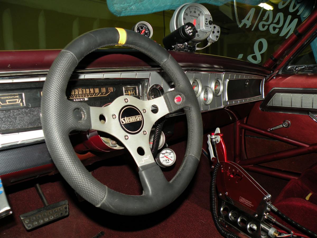

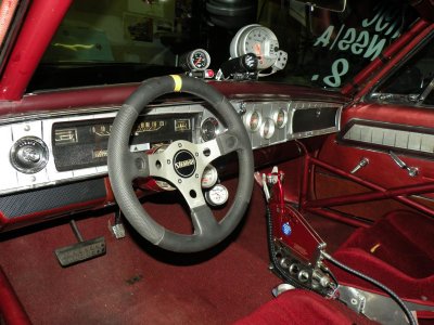

mine too.m newv to using a transbrake so i just put it on the shifter now. heres my solution.

Can you make the picture bigger?
I can't see what you are talking about.
Sorry no photos, but if you going to use the button on the wheel, you can just leave the appropriate amount, to go lock to lock hanging loose, then zip-tie the rest too the column & out of the way, so it's not winding in the center of the stretchy coil wire I had mine on the wheel like that for years, before finally going to a Lenco with the line lock on the shifter & also tried it {line lock & trans brake button} on the left side of the steering wheel for a while...

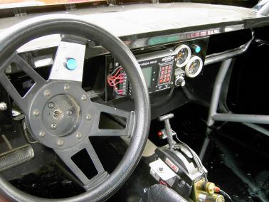

I put mine at the bottom of my shifter (black button) I let off the button and go up to the shifter and wait for the light BANG wait for the light BANG then wait for the win light. No cord to get tangled, and no accidental hitting the trans brake button. P.S. that turbo shifter is like a secret weapon for mopars.
