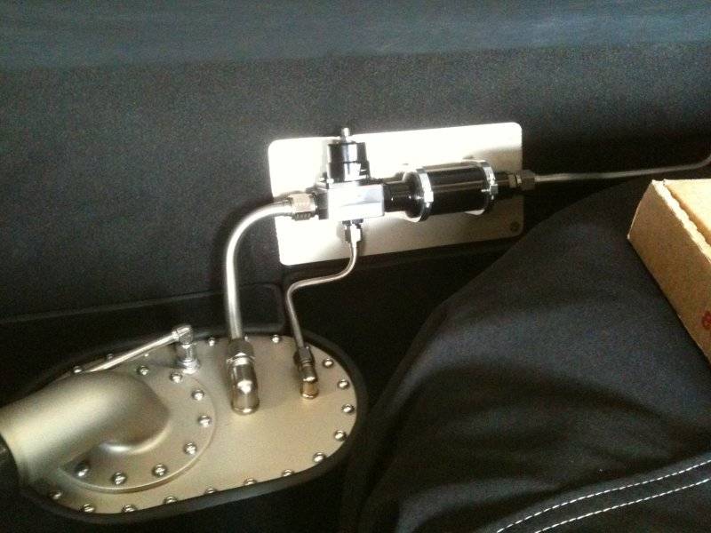

My advice is buy an efi tank. Your tank can me modified but its a lot of work.
Not on a '69. I did an in-tank on my '67 Coronet. I used 2 3/8" factory lines. Used 3/8" tubing to -6AN fittings at the ends where necessary to attach to tank bulkhead and to F.I. throttle body. For that last little bit, I used -6 PTFE braided line w AN fittings. PTFE will not rot from fuel or heat and is vapor barrier and can handle the pressure.
Tanks Inc efi tank, in tank pump, 'Corvette' fuel filter/regulator mounted near the tank, 1 line up to dual tbs, ptfe lines, Fragola fittings
If you use the Holley Sniper in tank pump you can dead head the system with no return line.

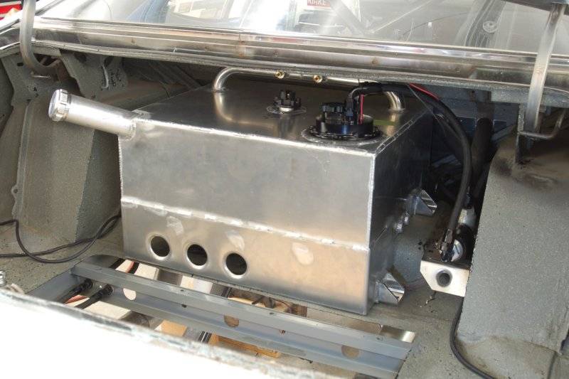

On my Duster project I built a custom aluminum tank that sat over the rear axle. The stock location under the trunk floor was consumed with the trans cooler and the exhaust system. The original owner had a fuel cell in the trunk but I wanted some storage space in the trunk so I moved the tank up into the kick up area. I used one of the big Holley fuel cell pumps that drops inside a fuel cell. The regulator sat on the frame rail next to the tank so the return line was super short. Then there was just one high pressure line up to the fuel rails on the engine. This setup worked out great. I had a level indicator in the tank, a sump for the pump to sit in, and a breather tube on top of the tank.
Not mine but a very clean setup ...
]Cool show-and-tell, but neither help me in any way. LOL.
