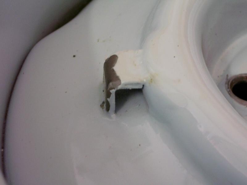

regarding the big hub cap, I can make it work by welding tabs on the wheel.

look for a c-body car, or late '70's chrysler/diplomat. tabs are fairly easy to do.
