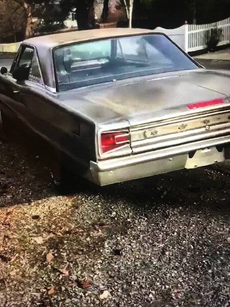

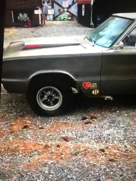

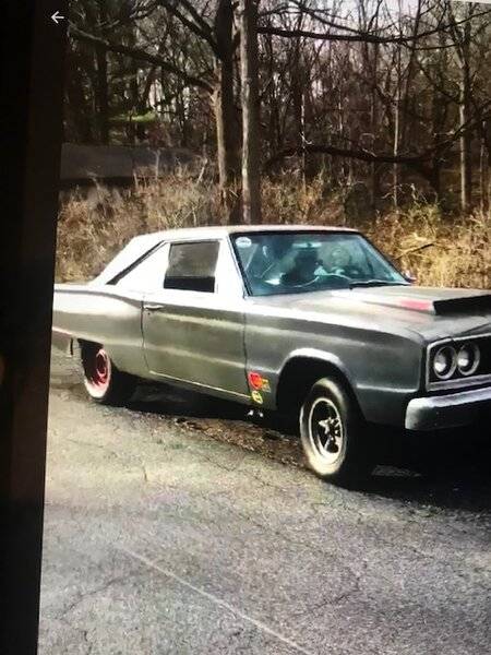

Looks like it's been dechromed.
Should have body length trim right in the middle.
I LOVE that trim. Makes it look lower and longer.
Also missing the Coronet, 440, and 383 emblems.
383 are available repro. Coronet and 440 are easy to find used and cheap.

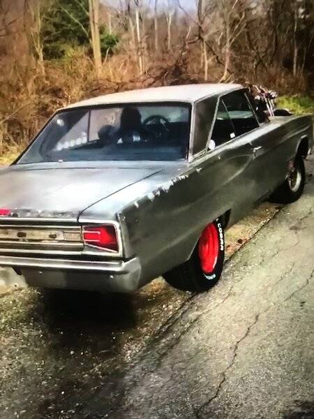

You might want to look right above the driver's rear wheel. Looks a little soft there or it may be poor lighting/camera.
There have been a couple threads on what to look for body wise on these.
Basically-
Above and around the rear wheels (all of those compound lines on the rear quarters almost never get repaired correctly)
Around that chrome trim where the roof meets the body. (another kind of bitch to repair)
Rear lower quarter and trunk drop off (lower rear quarter patch available but can be hard to find, full quarters unobtanium)
Front frame rails between shock tower and trans member (not too common but common enough to check thoroughly)
Trans crossmember (same as above)
Rear frame in the shackle area (not too common)
Inside trunk on the underside of the dutchman panel area (again, not too common but worth checking)
66 and 67 seem to either not rust hardly at all or rust real bad. Not a lot of in between.

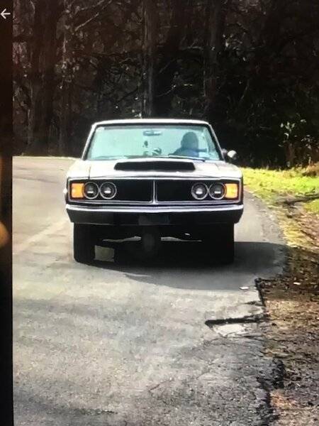

Front window trim is missing as well.
I'm skeptical
I'm skeptical
Ok, I was thinking from these poor pics, maybe both front and rear glass moldings are painted black......still waiting for that answer
Windshield trim is not too terribly hard to find or expensive.
Just be aware that 4 door/ sedan/ wagon trim is different, although you might be able to trim it down.
