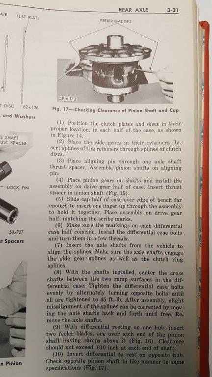

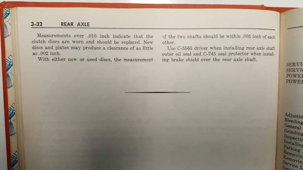

I was just thinking it would be a way to tell if the clutches need replacing without disassembly. It's stating that any measurement over .010 would indicate worn clutches.
From the 1962 FSM
Guess I need to take another look at how these things setup and take a look at the FSM's I have. Wouldn't think the 1962 manual would be different than one from 67 or older? I've always checked them with the T handles to make sure they actually grab and use a mix of rear end oil and STP as assembly lube. You would think the STP would make things more slippery but it's been a life saver for the POS Track Lok in my 2000 Durango vs the factory AND Ford LSD additive. Many times the FSM doesn't make sense to me but it's been several years since building a clutch type SG. I also just stuck a .005 feeler into that unit on the shelf and it was snug but it went in. On the other hand, I would have thought less meant more wear. Think I'll take this thing apart and remove a plate and see what it does. It just seems opposite logic to me lol
