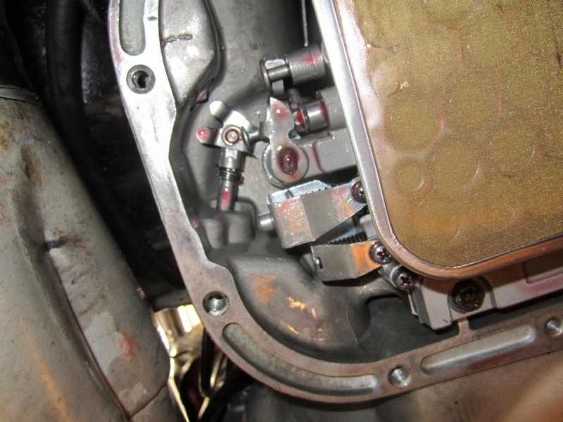

OK I'm not usually in this older car area but I need some help ,I'm working on my 1964 300 K I know it's not a b body but it doesn't mater, I just had the trans rebuilt and I got it in the car won't start now I can jump the relay and we're good . so I'm guessing the neutral safety switch ? but this is a very different setup then I am used to it's a floor shifted car but has two cables a park cable and then a gear selector cable. I see a switch on the side but it's a single terminal looks like a reverse switch, the trans shop shrugged his shoulders I ordered a part from rock Auto but it says 1970-2001 on the bag and it's a plastic thing with a rivet someone help me out here is the single terminal a neutral switch or reverse light switch . where can I get one as apparently rock Auto has gone insane in the membrane!

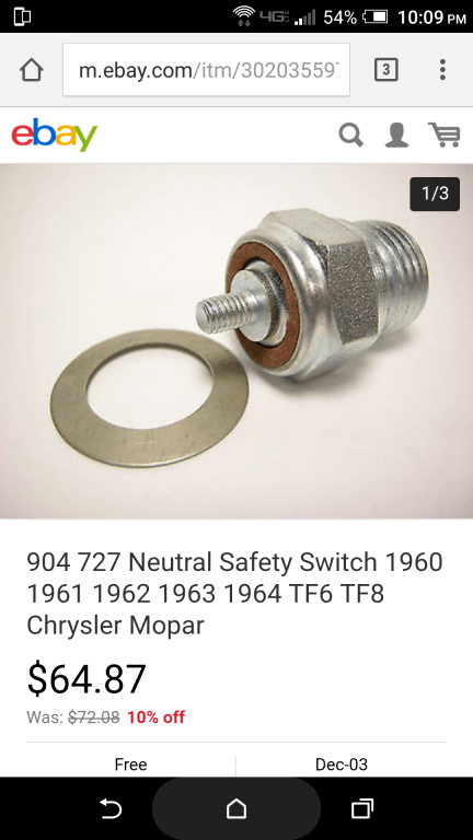

Well I just got off the phone with a old mopar friend he couldn't stop lol at me and rock Auto we figured out the switch I'll attach the picture of one after I found out a part number
Thanks guys I'll double check the grounds but I'm 100% sure everything is good . I'm actually familiar with this switch it's the same one that we used on the dump trucks trans as a reverse switch when the trans got rebuilt they always failed no mater what once the pressure is off the ball it brakes !

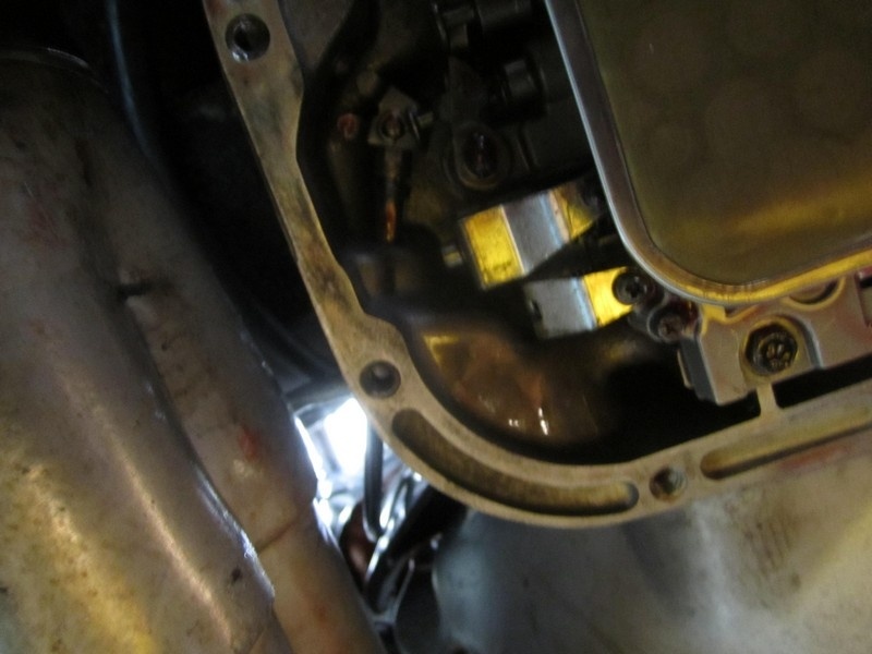

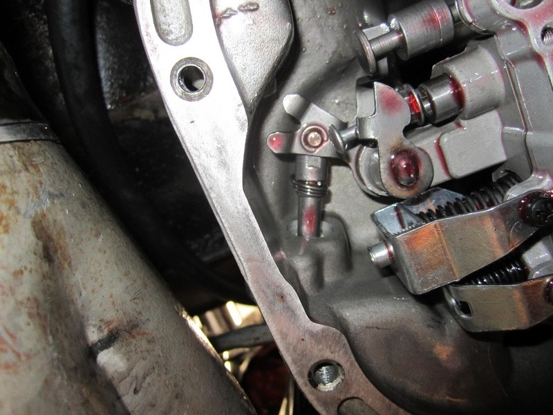

Have someone push the neutral button on the dash and see if the rooster comb actually touches the nss. It almost looks as if the fingers on the comb are too short to reach the nss itself. Hence the longer arm looking thing sonnax sent you. Does that somehow get riveted to the rooster comb?

Im basing my response it looks like he has the pan off. Im really curious what that little lever thing is that he posted earlier
That particular NSS only covers a couple years...meaning it's harder to find. Don't know if it helps, but the seal it takes is a cupped crush washer type. At least that's what's on mine.

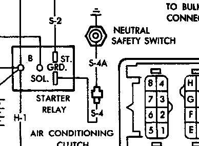

What your looking at is fairly easy to check! First, locate the single wire, that runs from the NSS to the starter relay. Make sure it's in good shape. Pull the wire at the starter relay, use a multimeter at that end, and check for continuanty to ground. Should have contact to ground, both when shifter is in park, and neutral.
If not...you'll get fluid out of trans...pull the NSS. Look in the trans, at the rooster comb...should have a 'finger' on the comb, centered at the NSS hole, both park and neutral.
You can also check the NSS (installed), via the shifter, going from the NSS's stud to ground, to see if there's contact.

2 different single pin switch styles. White plastic plunger and steel plunger. steel is longer than the plastic. Steel one has threads deep enough that the rooster comb can hang up on it. This will cause the rooster comb not to move all the way to neutral. If the switch is the shorter style it may not be depressed far enough. Easy to check. Ohm meter should show continuity to ground in neutral, then the switch is working. Look at the starter relay circuit. If you want to know for sure drop the pan and take a look. The amount of interference is very little.
