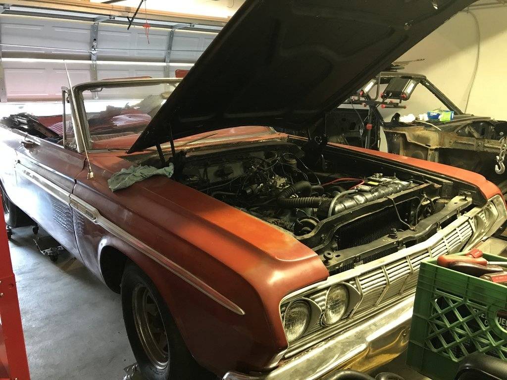

Wanted to see if there is any hope other than a bebuild for this transmission. The transmission works ok in 1st and reverse. When placed in drive or second gear I hear what sounds like a belt slipping, like it's trying to move but can't. Checked the fluid level and it's good. The car has been sitting for years and trying to get it on the road.
I want to add that when I bought the car it was not running. The PO told me 2nd and 3rd were not working. The PO had also removed the kick down lever or it possibly didn't have one when he bought. I purchased a kickdown lever but haven't installed it yet since 2nd ir 3rd aren't working anyway I figured I would install it after I get those gears working.
