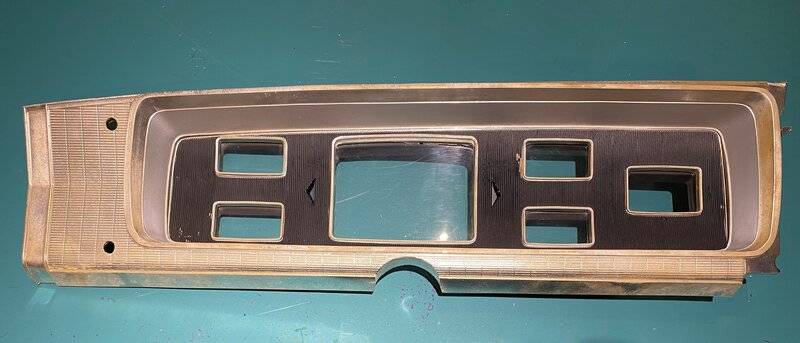

Does anyone know the different finishes used and in what locations? In my faded bezel, it looks like there is chrome around the rim of each gauge window and maybe on the thin rim around the black section. Then there is a band of flat silver surrounding the inside of the gauges - and then chrome around the entire perimeter. Does this sound right?
Anyone have pics of an original in good condition or a restored one?

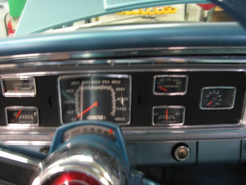

Redline gauge works did mine.Sorry for the crappy photo. It's all I got.

Redline gauge works did mine.Sorry for the crappy photo. It's all I got. View attachment 1241978
As crappy as the photo is, it tells me what I wanted to know, lol. I see enough reflection around the individual gauges to know that is chrome, plus you confirmed the flat silver band as well. Thanks!
