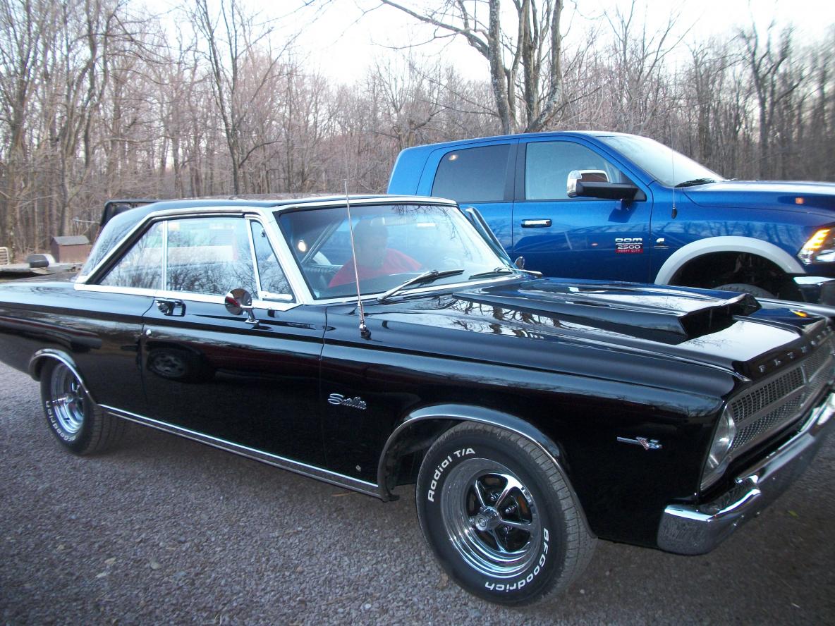

Hi everyone. Im new here and new to the b-body world. I've had my a-body for 25 years and when I saw this Satellite I had to have it. It is a driver with needing a little TLC which fits my "lack of time" life style pretty good. I has a 426 4 spd in it now and the owner had just bought factory manifolds, intake, carbs, bolts, linkage,cam and exhaust to convert it to cross ram. I am not sure if that is factory correct or not but it will sure look cool. Does anyone have pictures of this style set up that you could post? I would like to try and make it look factory atleast. I am sooooo excited to have a driver since I made my dart into a drag car 12 years ago. Since then I would have to take DADS nova or WIFES mustang to the local car cruises when I wanted to take a car instead of the bike. Thanks again...

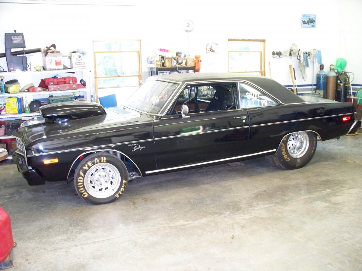

Dart
This is my other car

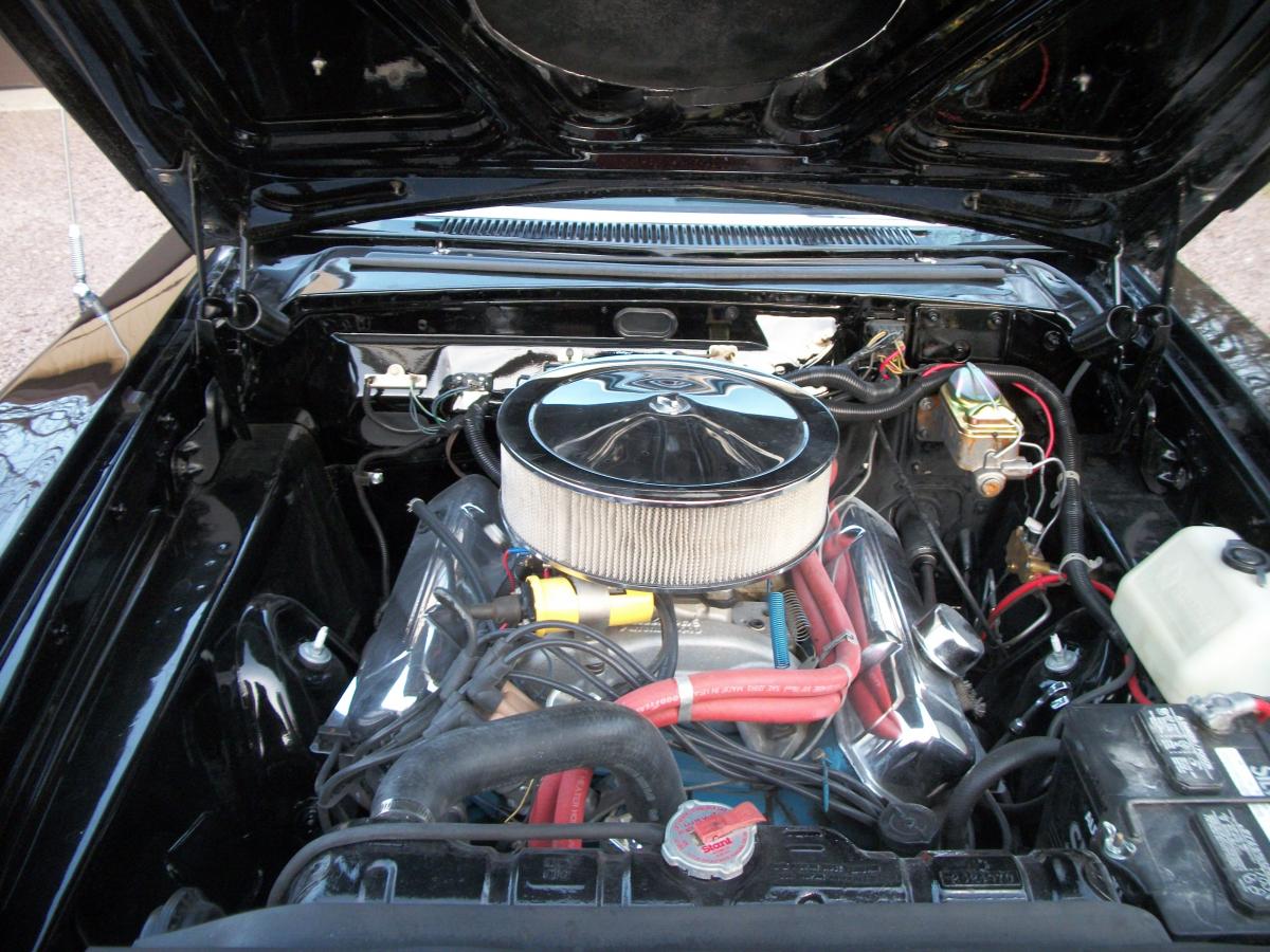

Welcome Pahighlander--Sharp car--only a few 65 Satellite 4-speeds out there. As you're most likely aware, the max wedge (with crossram) ended production in 64 and the biggest available engine for 65 (unless your last name was Sox-Martin, Landy, Lindamood, etc. in which case you could get the race hemi--and even then, not in the Satellite) was the 426 street wedge rated at 365 h.p. I always felt Chrysler turned their back on those of us who wanted something much hotter and so when I had the opportunity, put together what I thought we should have been able to drive out of a Chrys-Plymouth dealership; plus, I like the "WOW" factor when you first open the hood. If you want more details, let me know. Like I said, beautiful 4-speed car--congratulations. Bob L.

Your max wedge exhaust manifolds will fit just fine with power steering. I don't have pics of the underside of my hood, but because mine is an RB engine (440 raised block) with a re-pop max wedge intake from A&A Transmission, I had to remove the cross-webbing in order to clear the max wedge air cleaners. If your engine is the original 426 street wedge, yours will clear.

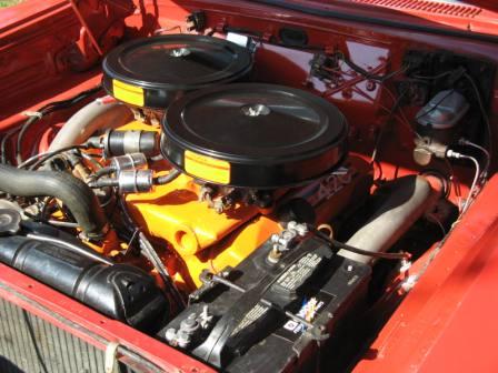

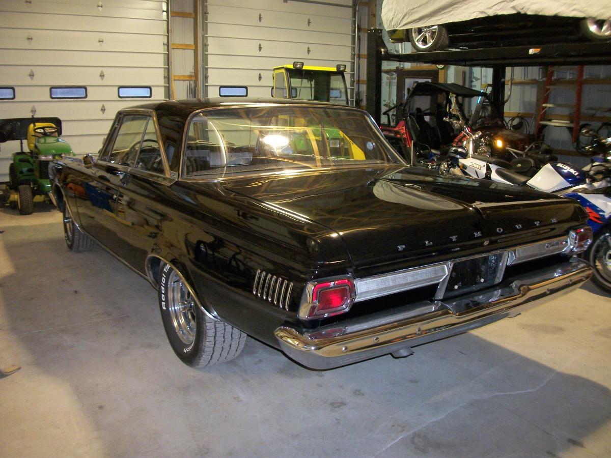

A couple of really nice looking 65s here, and the cross ram looks at home in there even though not available from the factory.
