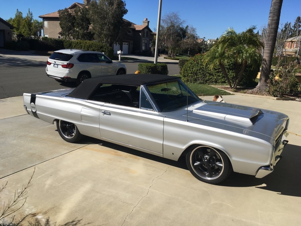

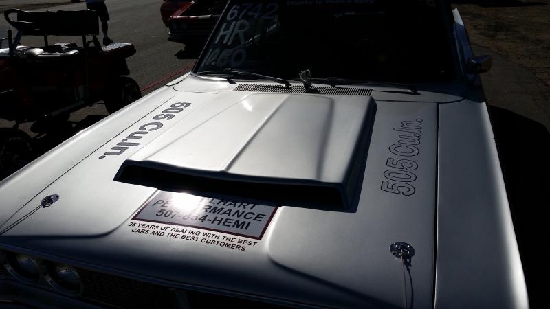

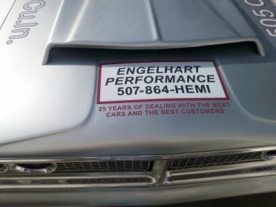

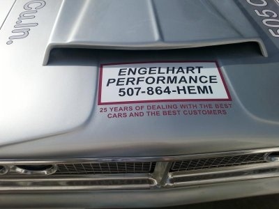

I've attached picture of Mike Gaines RO Hood Scoop which I bought.
"I am selling it because I have to go to a MUCH TALLER style scoop to accomodate my Tall Single Plane and Dominator with the 2" adapter which just wont fit under the RO Hemi scoop that I am selling."

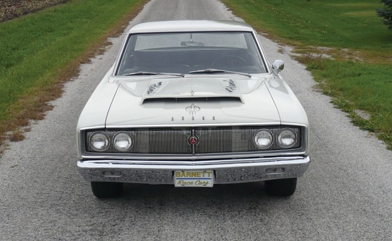

Also attached a picture of 66Satellite47 Car as I had it saved on my desktop for inspiration. He is using the extra tall version, with two stanchions. :thankyou:
Mike's old one scoop, only has 1 center stanchion

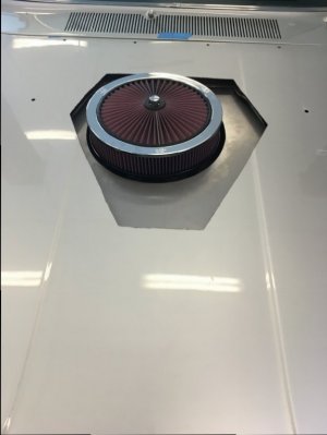

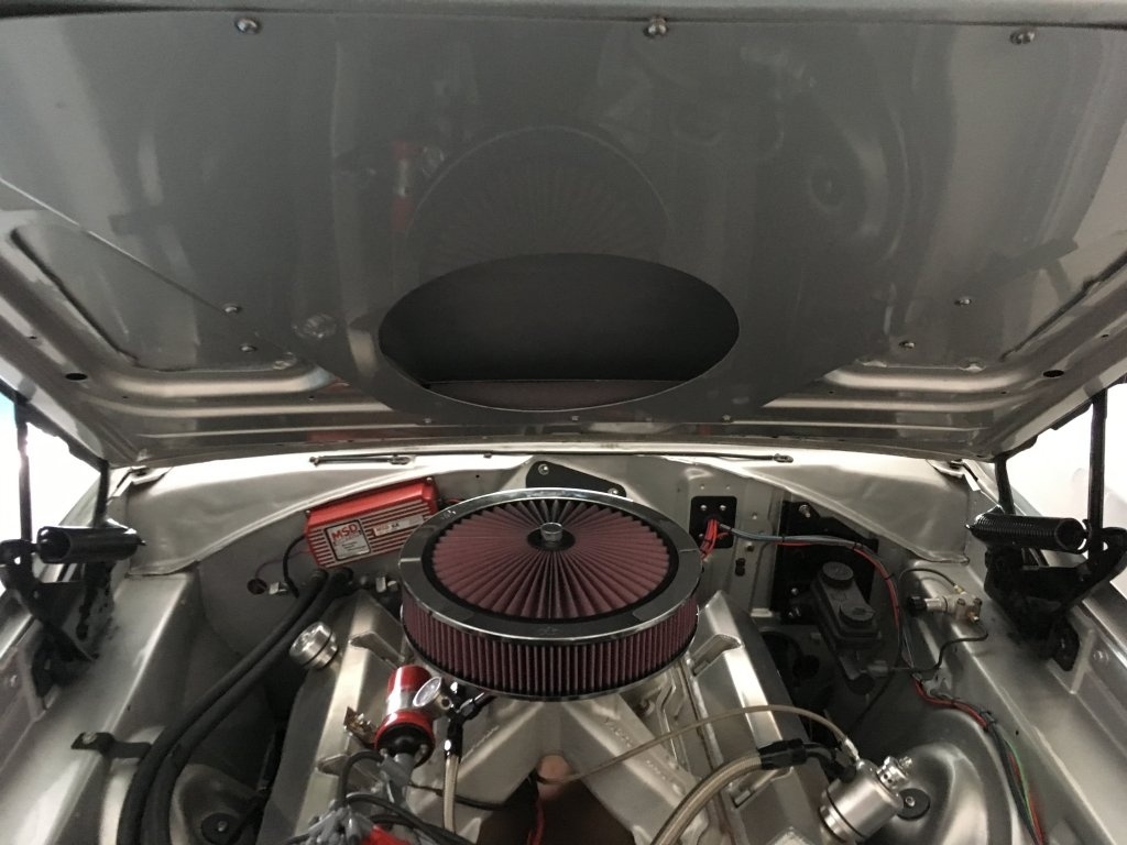

I am hoping to keep my custom cold air. We modified the air cleaner base to drop it as low as possible. I am using an 1/8 inch phenolic spacer and the air cleaner just barely rubs the hood so there is no way I can use a taller manifold without cutting a hole in the hood. I am only interested in using the low profile scoop.
