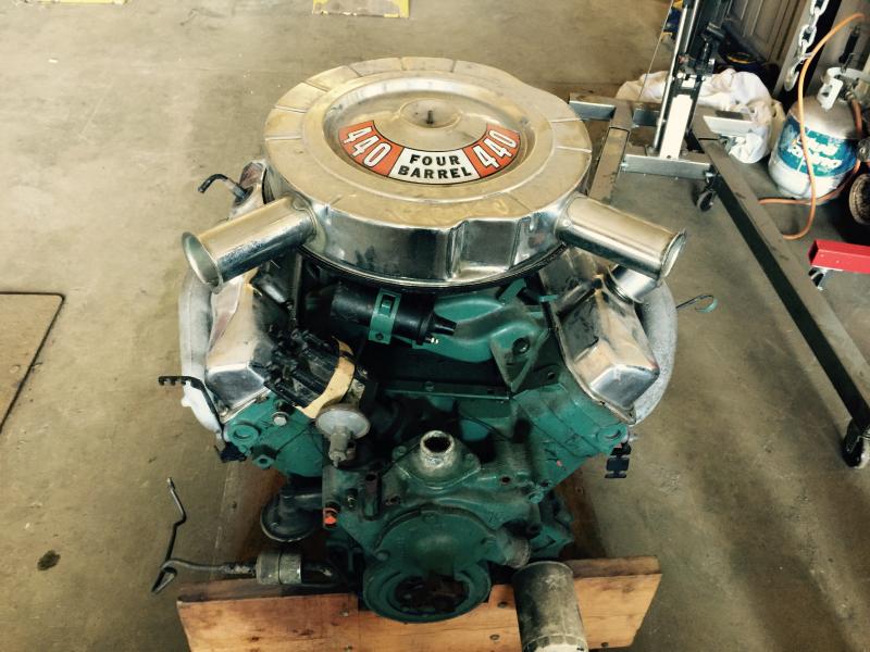

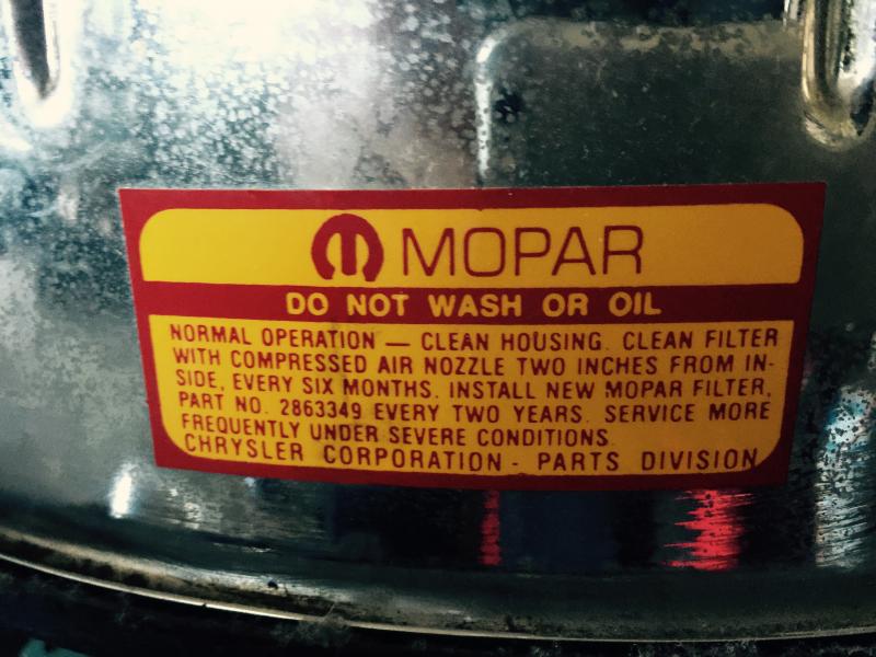

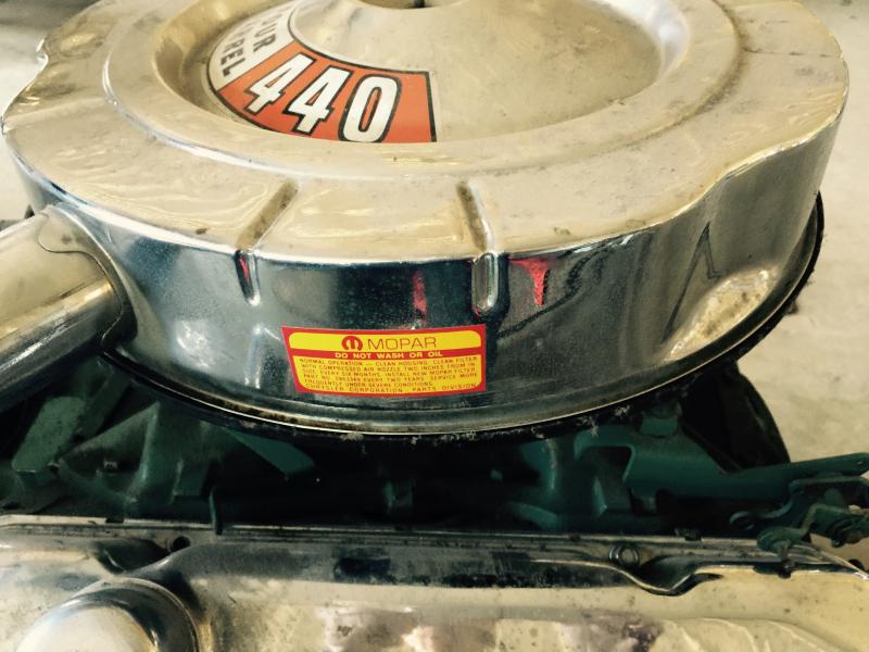

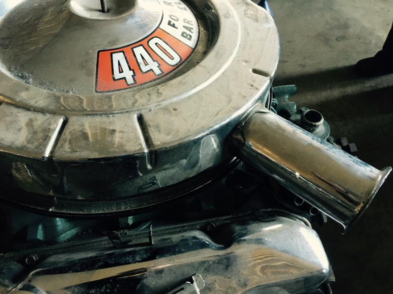

This motor has been sitting for 20 years in a basement. It's a 1967 440 HP out of a GTX. I have never seen a chrome air cleaner. Is it factory?? image.jpgimage.jpgimage.jpgimage.jpgimage.jpg
Could be factory but not for a 67 GTX.
A GTX will have the Super Commando pie tin.
Should be black wrinkle.
Twin snorkel for automatics.
Unslienced for four speed.
this came out of an automatic car. the motor was taken out to be replaced with a hemi 20+ years ago.
And the Dual intake snorkels will be an "Oval" shape
