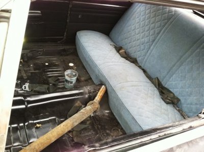

I also have this blue seat in the back, which may have been stock. Any ideas? I'm thinking if just having it reupholstered.

Yes, the headrest was an option. Not all chargers came with the headrests. But all Chargers came with bucket seats. Never seen one with a bench seat. Yes the 68 had the off color Horizontal pleat in the buckets and the back seat. You can find new ones from lots of sources. Including Legendary.
Hope this Helps.
MH
Head rests optional on 68' (Bullitt movie) standard in 69'. If you have a charger, your already a lucky man!(or lady)

Legendary has seat covers. I don't know about the seats themselves. I'm not sure if the middle buddy seat/armrest was an option, as well ?
