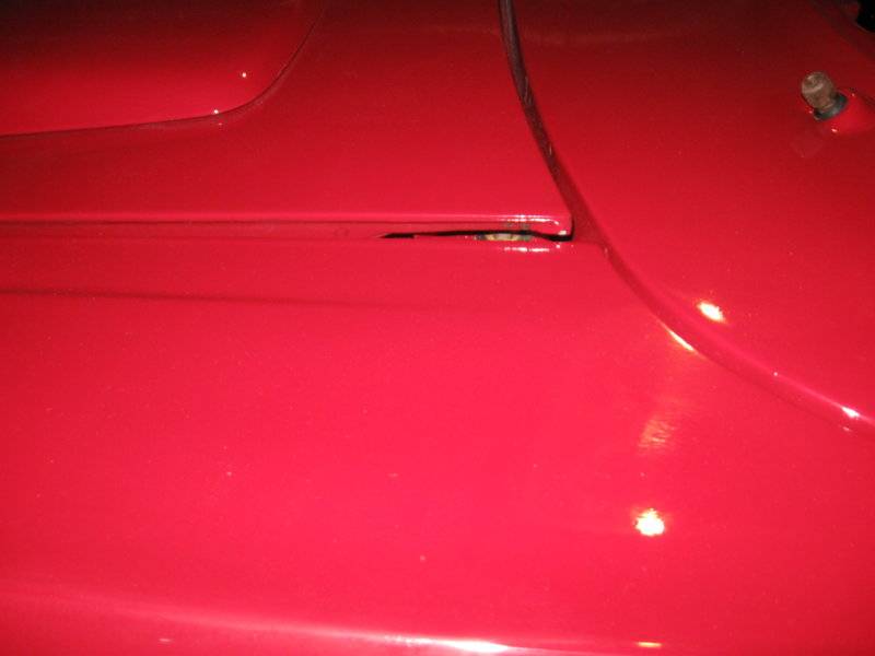

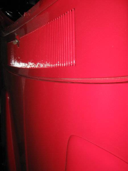

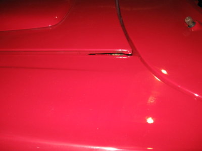

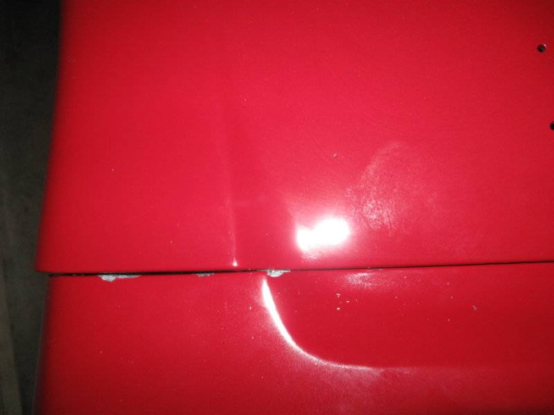

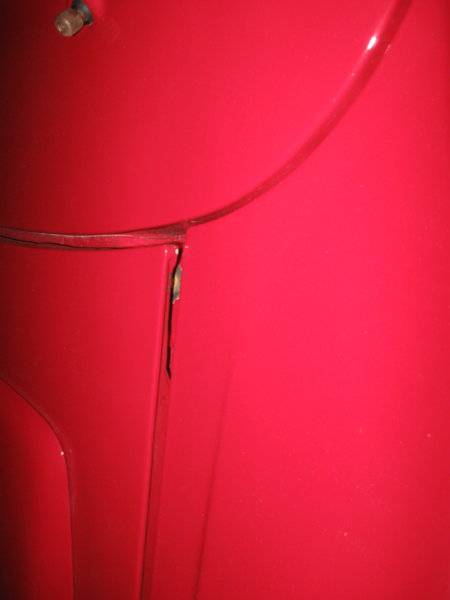

how do you adjust hood see pics below. thanks

Is the engine in the car?
I think you might have to adjust the fenders and the hood. I take it the fender gap on the passenger side is wide? Is the rear gap on the hood the same on the passenger side?
Did you put sealer between the fender and the inner fender?
These cars were never perfect from the factory. There was lots of room for adjustments . Hows your door to fender caps?
Looks like the hood needs to go back. Hinge to hood needs adjusted, slide it back.
