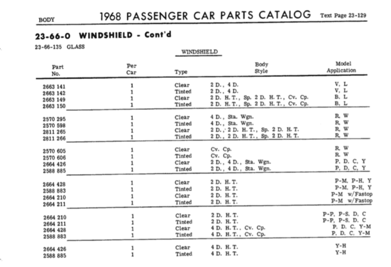

Is there a difference between a wagon and a sedan as far as the windshield is concerned? Some are saying there is and others are saying there isn't.

LOL the glass and I appreciate all the responses/information. I have done some research and found a few sources. The AMD stuff seems to be for 2 doors but I am not positive on that yet.
So AMD has one for a 66-70 B body Convertible, doesn't say anything about 4 door or wagon. Is there a difference between a Satellite and a Belvedere?
http://www.autometaldirect.com/amd-...r-hardtop-66-70-b-body-convertible-p-753.html
I did some looking around, looks like I was wrong, Convertible isn't the same... Don't know why, it has the same more upright angle as the 4dr & Wagon but it's not the same glass...
Thanks, I wonder what the difference is? They seem to be a bit difficult to find (according to the car's owner who has been looking). I haven't looked all that hard but have seen ads for windshields on like eBay where they are saying 4 door, wagon, etc. which makes me think that either they don't know what they are talking about (most likely) or whatever difference there is isn't significant enough to preclude using one in a wagon.
