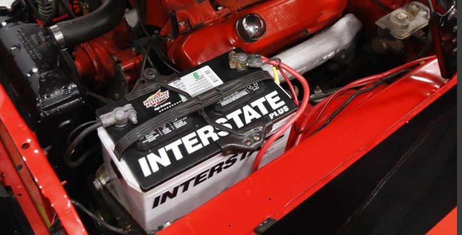

These three pictures tell a lot, and none of it is good. Lipstick on a pig............

I don't have enough time to chronicle everything, but, since you asked...................
Top picture: The interior of the door should be black, not red. Strike playe painted.
Middle picture: Painted the VIN with the dash. Also looks like they painted over some leftover masking tape glue.
Bottom picture: Everything in the engine compartment was painted red including cam bolts, inspection covers, aster cylinder reinforcement plate, & wire loom & the heater hose bracket. They couldn't fill in the crappy hood pin holes in the upper rad support. Valve covers are gloss and the rest of the engine is dull. No heater hoses or washer bottle/hoses/squirters.
You can see that the stripes are gloss and what's with the goofy mask job on the leading edge?
Speaking of goofy, what's with that shifter boot?
By looking at the pictures, I would agree someone fixed this car up for a quick flip. Many wrong details that speak to rushed work. That doesn't mean that the bones of this car aren't good, but I would be worried. Rusted areas that are newly painted will look great for 6 months to a year, and then the rust will all come through again. Quite frankly, I am personally leery of buying most freshly painted cars. I would rather buy one painted two years ago. You get a better idea of the craftsmanship of the work. If a car is freshly painted, then the details matter. If a freshly painted car has all the correct details, then they probably did the bodywork with the same level. If they rushed the details, then they probably rushed the bodywork too...
